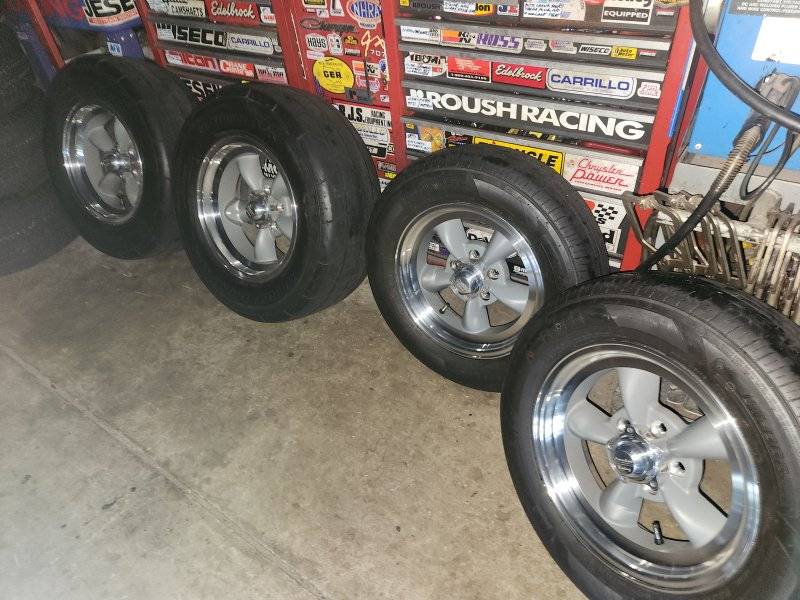

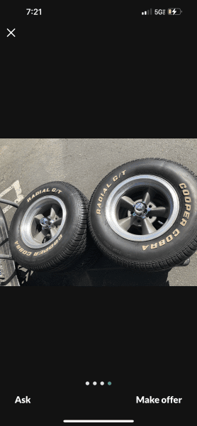

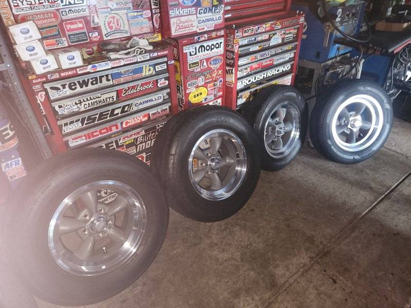

Hi guys how about this combination are these too small? They are going on my 69 coronet
Too small In my opinion. I always liked 15x6 on the front and 15x8 on the back. 255-60's on the rear minimum.
If you have disc brakes or plan on disc brakes the 14 inch could be a problem.
I like them. Period correct and cool.
Big 14" tires are going to be harder to find, as time goes on. That is why I switched to 15" rims on my cars.

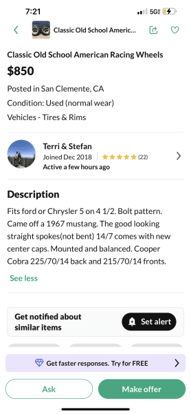

I think for $850 I'd spend a little more and buy new 15" wheels and tires. I think you'd be happier long term.
I like them. I just picked up something similar recently. I always run 295's on the rear.
I love gray five spoke torque thrusts. But I doubt I would buy 14s. The biggest 14s available that I know of are 245/60-14s. I'm not sure how long 14s of any size will be available
On the other hand, my collector car tires ALL time out, long before they even think about wearing out.
Before I committed to buying those wheels/tires, I'd find out exactly how old the tires are.
Edit: they are seventy aspect ratio, meaning they are pretty tall, which means they will fill out the wheelwells better than a shorter tire.
