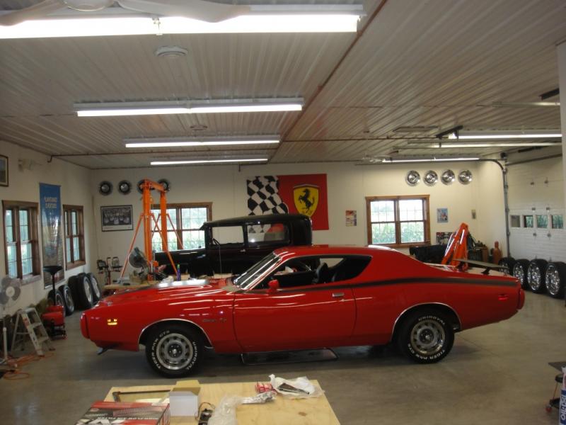

If you can find the time, please post some pictures of your cars - We Love pictures
Enjoy the site
Ma Snart
My 71 Charger for your viewing pleasure - More pictures of my Mopars in my gallery
