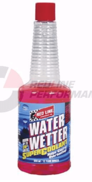

Mine is fairly clear..... Water plus Water Wetter. Maybe a slight pink tinge, but not noticeable.

Due to the heat here, 120°+, I run 50/50 w distilled and 2 bottles of Water Wetter. So far in 105° this yr, 185 t-stat, mechanical fan w shroud on 496, never over 195 in stop n go n never over 186 while steady cruising. Made a damba$$ mistake this morning n stated my car to check the fuel injection, got distracted inside n forgot for 2 hrs it was idling in 85° weather. Was steady 184° when I remembered n oil pressure was great. Oops. But for 6 months now the coolant has stayed the pinkish cloudy.

I have a relatively new engine....still tight really. So I have flushed the engine a couple of times - mainly due to a perforated radiator a couple of years ago. Radiator now new....and before doing a Christmas parade in 2019, I made sure that the Water Wetter was a decent percentage....as our Christmas is in mid-summer. Temp held until right up to the last turn when I could get a little more speed and air-flow happening....maxed out at 220F toward the very end of the parade, but maintained a steady 208-215F for the second half when the Chinese Dancers were taking their time, and fannying around too much. :rolleyes:
In normal running without delays, I sit at around 178F, and it can creep up to 185F...maybe 190F while negotiating traffic. But overall, the temperature is pretty good. Better than running regular coolant....never had much luck with that stuff ...even my GTX used to get hot at times.

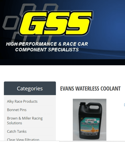

What is everyone's thoughts on Evans waterless antifreeze?
I have never used it....don't even know if it is available out here.
Google proves me wrong...
Evans Waterless Coolants are the ONLY 100% waterless automotive engine coolant available on the market. All Evans Waterless Coolants are a chemical blend that results in more efficient cooling due to a higher boiling point. The increased boiling point of the coolant eliminates the occurance of boil over, cavitation, and detonation. Not only do Evans Waterless Coolants not boil over, they do not freeze. At extreme cold temperatures the coolants contract and become extremely thick, not becoming solid and expanding like antifreeze containing water. Because Evans Waterless Coolants do not contain water electrolysis and corrosion are also eliminated. Every Evans Waterless Coolant requires the entire cooling system to be drained (radiator, engine block and heater core) and refilled 100% with Evans Waterless Coolants. No need to add anything.
Agents are a local Speed Shop close by to me. I might look into that one day.
What I've heard about Evans is that there can not be any water in the system at all. You can't add water to the system if it needs any, only more Evans. So if you would happen to spring a leak, you have to have some extra Evans on hand. Close to $50 per gallon. No thanks.

Evans Coolant has zero water, but is propylene glycol which has totally specific heat characteristics (ability to capture and release heat)....some people swear by it, others swear at it.....plus it is very $$$$.
