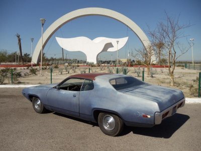

if I am not mistaken, both our full and canopy vinyl top classic muscle cars are all rusty under the vinyl top. My question is how was that even possible, I can't picture the factory painting a car with the vinyl top already in place. What am I missing here? Thank you.
Photo is my '72 SSP with canopy vinyl roof removed (it's rusty under there).
Vinyl tops are porous....water gets through eventually, and sits there festering away for years unchecked.

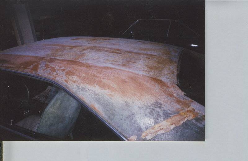

Maybe this will help answer that question. When I removed the original vinyl top to be replaced I saw that the car was only painted body color past the areas that the top would be covering. The rest of the roof was gray primer only. If it was known to the painters that a particular car would receive a vinyl top, it wouldn't make much sense to have the top of the car receive the same attention as the body if it was going to be hidden anyway. Primer? Not the greatest rust prevention.

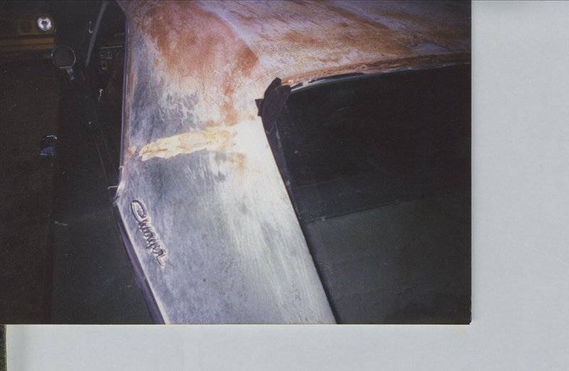

Furthermore....it is likely that there will be more rust marks underneath the area where the stitching is...as water can get through there easier. And it more likely there is an air gap under that stitching for rust to grow.

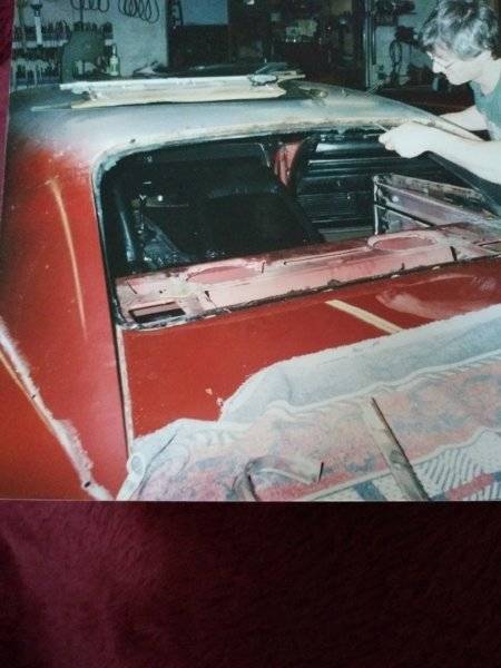

My '70 Charger after I stripped off the rest of the shredded vinyl:
