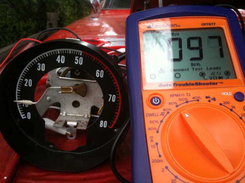

Wire it up to a running car on the fender.
I "Bench" test tachs like this on my Duster. It's easy enuff with clips on the wire.

Is this a factory tach or a Sun or something? The factory tach for my 69 RR has two terminals and one goes to battery pos and the other is the signal, or coil neg. Ground, or battery minus, is done through the tach housing. You will need a car with a conventional points ignition to test it.

I just calibrated my tach, yesterday, it also only had two wires. I hooked up the blue wire to positive and the other to negative of the coil. I have electronic ignition. I then grounded the frame of the tach with a jumper wire. gerry

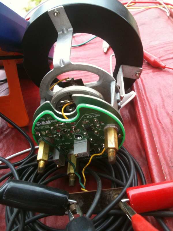

Like everyone says, 12 volts to one wire and the negative coil wire to the other. And ground the frame of the tach. I did mine this weekend after I installed the Real Time Engineering tachometer kit. :sSig_goodluck:
Dan
Be careful hooking it straight to the battery, because if your battery runs hot (higher than 14 volts), it could spike the tach. The best bet is to find a switched 12V source. You should be able to get that off of your fuse box under the dash. You need to do this anyways when you put it back in the car. Otherwise, it's just like everyone else said, 12V to the back of the tach, wire from other terminal to the "-" stud on coil, and ground wire from the case of the tach (wrap wire around one of the screws that mount it to the dash) to a ground on the car.
The Spade terminal on the back of the tach goes to the negative side of the coil (signal) gray wire.
The longer stud goes to 12v switched power. (blue harness,goes to fuse block for acc.)
The case is ground.
My experience with the "Real Time Egineering" circuit board, is that all it does is make the pointer "move",so most people "think" they fixed it, I've checked probably 50 tachs using those, and "All" of them were inaccurate,
and if you have a bad Meter,it won't work at all!

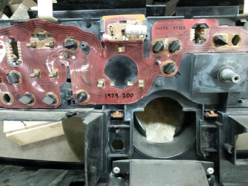

How do you bench test this tachometer from a 1979 Chrysler 300! Thanks in advance, Tony Tee.
