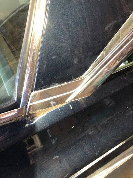

How do I get this off?
Nate S
4:31 AM
Apr 24, 2020
1,342
1,428
Connecticut
I really don’t enjoy taking trim off. Anyway, sucessfully removing most of it but not sure what’s behind this one. Kinda pivots around but won’t give up. I hate to work it too hard and break something.
A stud that must be accessed from the back side. You have to pull the pillar cover.
Mike
So down near the corner of the headliner? I guess I’m not surprised.
You might get lucky and be able to get to it from the trunk.
I followed 493 Mike’s directions. Only way to do it is by pulling back the headliner. Doesn’t seem to have caused any harm, just a nuisance.
