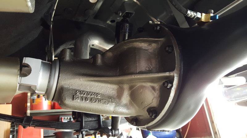

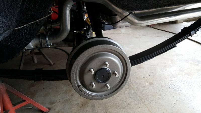

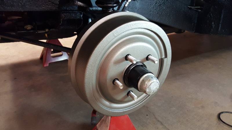

I used Duplicolor "Cast Iron". Buy it at Advanced
