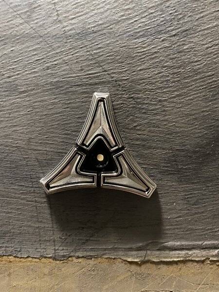

Looking for input on how to mount the Fratzog emblems to the vinyl top. It looks like there’s supposed to be a screw or rivet that goes through the middle. No screws came with the emblems.
Screw in the middle and the alignment pin. Should have been 2 holes in the top if it had one before.

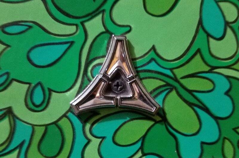

I'm not sure, but on some years the head of the screw was painted black. At least on a couple of mine they were.
You also need the inserts for the 'push pins' in the holes where the pins are.
The screw will be a countersunk Philips head about 3/8" long at most.
Perfect! Thanks everyone. It’s not easy to find Phillips head screws these days lol
