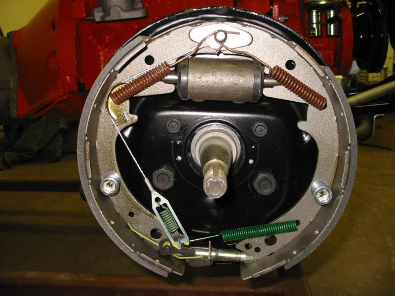

Made It! I am restoring a 1969 Plymouth Road Runner (started in 2008). I have not given up! I am currently installing the front suspension. So far, i have been successful installing k member and control arms (upper and lower). Now I am on the brakes. I want to keep the 11 inch drum brakes on the front. I am having trouble installing the auto adjusters on the front brakes (I have not yet started to install the auto adjusters on the back brakes but will in the future). I am wondering if any one can post a picture of how the auto adjusters look installed (front and back would be great). I need to see how the adjuster hardware works with the rest of the brake hardware. its like rubics cube? Its a mystery to me. I done many brake systems in the past, but this one I have not done. so any pictures or diagrams would be greatly appreciated. Thank you for you time in reading this.
If no one comes up with a picture, I'll grab a photo from my shop manual later today.
should look like this, the pic is of the right (passenger) side.
thank you so much for responding to my help request. 440+6, provided a picture. thank you again! Wild Bill
440+6, thank you again for the picture. I went home after work and was able to successful install the auto adjusters on my RR. I could not have done that without the picture you sent me. It is a beautiful thing! :eek:ccasion14:
You are welcome, glad I could help.
