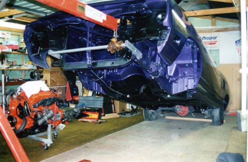

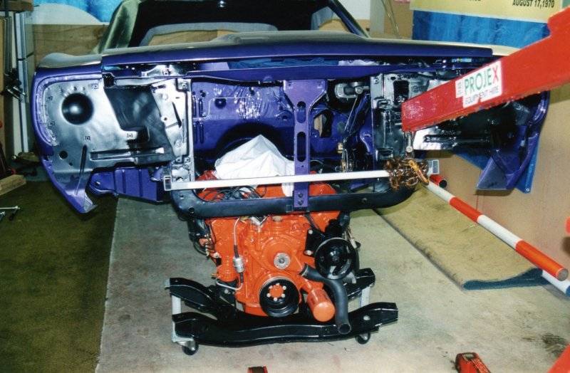

42. front bumper
43. front valance (if applicable) with directionals
44. front & rear side marker lamps
45. rear bumper
46. radio antenna
47. fender emblems (if applicable)
48. rear of fender splash shields
49. undercoat wheelwells
50. exterior emblems
51. windshield & backlite stainless trim
52. windshield wiper arms & blades
53. other exterior trim
54. taillights
55. mid body/rear lamp wiring harness
56. dome lamp wiring harness
57. shoulder harness clips (if applicable)
58. rear headliner grip strips (Bbody)
59. Headliner - why doesn’t this go in earlier – before the dash ???
60. roofrail c-channels
61. roofrail weatherstrips
62. windshield & backlite moulding clips
63. windshield & backlite
64. upper control arms on body
65. fuel hose clamped on body side fuel tubing
with keystone crimp clamp
66. install rear leaf springs front only
67. position rear end housing on springs
68. loosely fasten u-bolts
69. lift rear axle into position and install shackles
70. connect e-brake cables
71. connect brake line tubing & hose
72. DRIVETRAIN SUBASSEMBLE
a. K-member
b. engine
c. carb(s)
d. starter
e. alternator
f. fan & fan clutch
g. power steering pump (if applicable)
h. belts
i. motor mounts
j. trans & related hardware
k. lower control arms
l. strut rods
m. center link, idler arm, tie rods
n. steering box & pitman arm
o. fuel pump and tubing
p. fan blade
q. radiator hoses
73. drop body onto drivetrain subassembly
