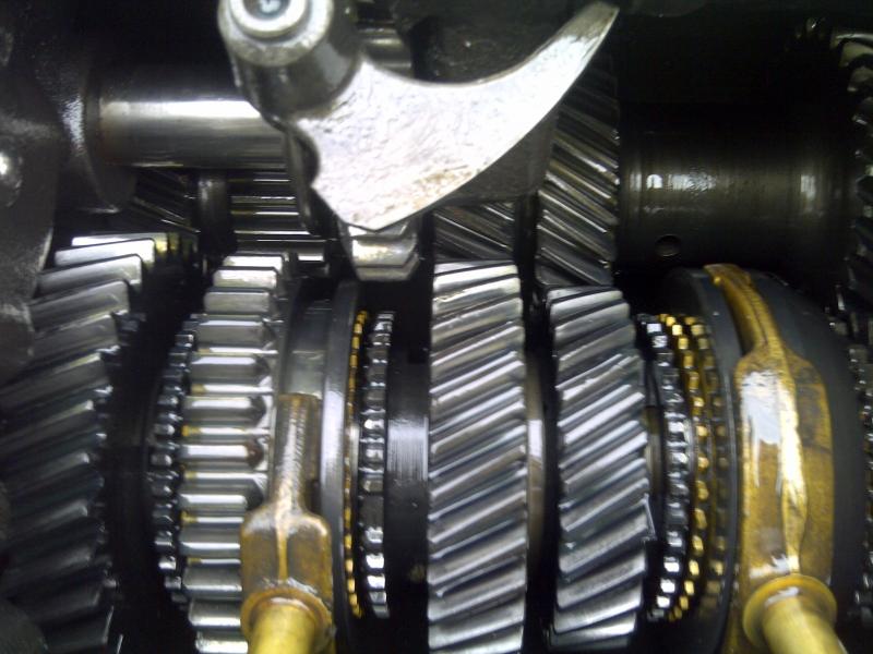

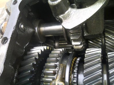

Only reason I bought this trans was because the synchros and gears looked pristine when I opened it up to inspect it. The levers were still attached, so i shifted thru all gears by hand first, all very smooth. Whatever fluid was left when I opened it up was pretty clean, no metal filings, no rust, no chipped teeth, clutch forks looked solid. Not sure if you can see in the pics below.

After doing a half dozen of these things my experience is you'll never know what you'll find. I've had an unbelievably cruddy one that actually was near perfect internally after cleanup. My latest 65 Satellite had an untouched original trans (133k) that looked every bit as nice as yours inside (drove perfect) but was a leaker at the shift o-rings. The reverse idler has to come out to fix so I just decided to take the thing apart & re-gasket on the cheap. Amazed to find the countershaft & rollers near completely wasted. My recommendation is to not buy a kit to start, rather disassemble & see what you have. The Brewer’s kits do use Chinese bearings, they have no problem with them & I’ve used them before but there are better ones out there. Based on work experience (power plant) the SKF’s are the best followed by Timken. You can even get the SKF’s with extra ball (9 vs. 7?) which makes them much stronger. You don’t want to buy the ball bearings from a trans shop. Find out what the SKF or Timken part #’s are & then buy on e-bay- they are actually just standard metric bearings used on stuff not limited to transmissions. I got some smoking deals on SKF’s which retail for over $100 for $20-30. Rebuild is not hard at all but there are lots of little things you need to get right to do a first rate job- get a factory service manual & careful to keep all your parts in exact order. Only really special tools you need are good snap-ring pliers, a caliper (if you replace the select fit snap-rings), & some sort of dowel for replacing the countershaft/ needle bearings (I use an old 3-speed countershaft for this). You also need a press for removing/ installing the bearings but any trans or machine shop should be able to do this. Also, if you replace the front bearing, make sure you re-use the original bearing snap-ring which is thinner than the those on the replacement bearing or you will crack the cast bearing retainer (ask me how I know). Here’s my 65 Sat tranny on the kitchen table-
