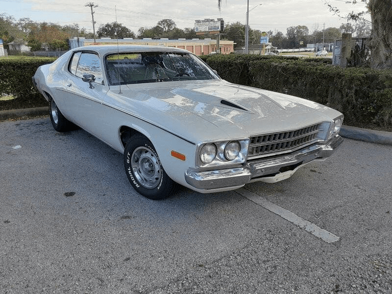

I have a 73 Plymouth satellite with the factory hood and front end, but I think the 71 and 72 front bumper looks much better and was curious as to how difficult it would be to fit it on. would I have to replace both front fenders with a 71/72 satellites?

I don't think the 73/74 bumper looks bad at all I simply just like the smooth look of the 71/72 more. I'll try to get some measurements but if it ends up being to much work I'll definitely just stick to the factory bumper.

Another option if you have not already considered. Removing the 73 bumperettes will clean up the look.

Lots of people eliminate the gap on 73/74, but it's way easier to simply slot the 73/74 bracket than to try to get a 71/72 bracket to work. That ISO mount puts the bracket about 3/4" lower.
It's pretty easy to remove the front guards, and it really does clean up the look.
I've never had an issue with the way 73/74 Satellite front ends look, and I agree they look more "traditional" than the somewhat polarizing 71/72 "lipstick" loop.
