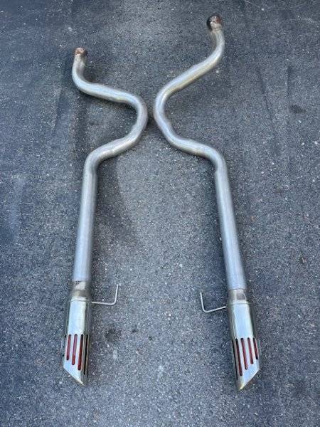

My Mopar mechanic bud is closing up shop. He's had these exhaust pipes and tips for probably 15 years off someone's BB '71 or '72 Charger. He's cleaning out his shop and knew I wanted them so he gave them to me. 2" pipes, I believe original tips but aren't sure.
Before I take them to the local custom exhaust franchise, I have a few questions. I figure I have two options to put them on my '73 SB Satellite: hopefully they fit to the mufflers, bends in the right place. If not, have them cut off behind the tips and fit them to my Frankenstein exhaust (turndowns). I'm ordering new exhaust tip hangars from Classic Industries. My pipes are slimmer than 2" but figure the exhaust shop can weld in adaptors or something. Obviously I'm trying to go the cheapest possible route.

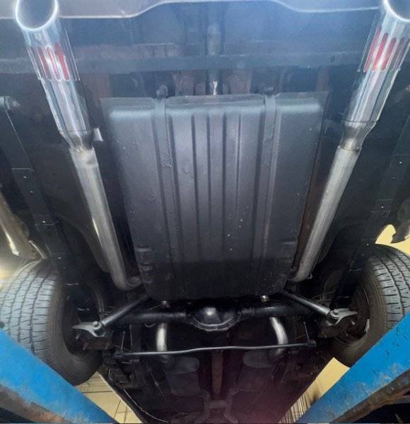

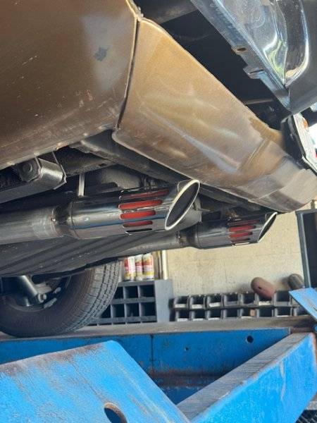

Tips and tail pipes on my car. Had to weld the tail pipes to the muffler outlets, 2.5" down to 2.25" or 2"
