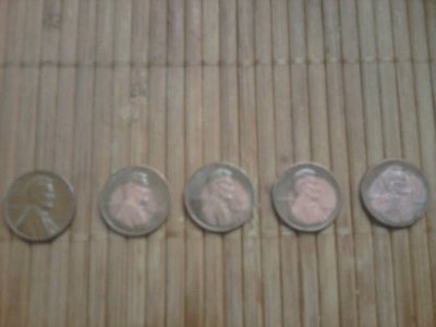

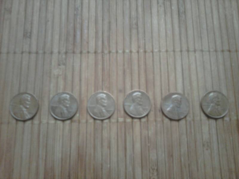

OK, so before actually testing on my cherished wire harness, I did a quick experiment using pennies. Here it goes...
The left penny was untreated, the others pennies were (from left to right) exposed to 30 seconds, 1 minute, 5 minutes and finally 2.5 hours (the time it took me to run a few errands). Picture is abysmal, but the unoxidized patch in the middle of each treated penny is almost as shiney as a new penny.
As you can see, almost all improvement came within the first 30 seconds with no observable improvement until we reached 2.5 hours, but even then it was almost too little to really see. Great news! :hello2:
