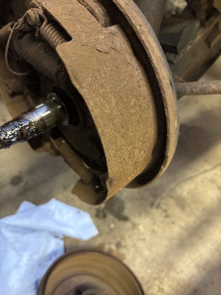

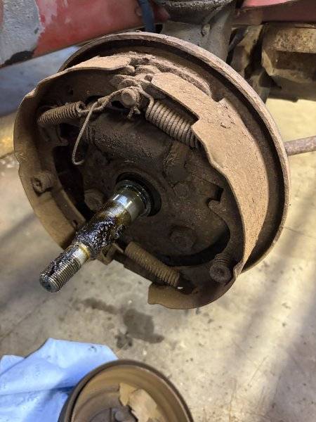

How many miles do you think are left on these brake shoes?
Looks like the bonding came apart many years ago and someone just kept it together to keep it rolling...

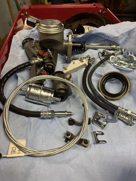

Looky here... both hoses for the front drums on my Coronet.
The small diameter are from Dynamic Friction... the larger are Dorman.
Inside diameter is different, too.
Thoughts?
Which ID matches your brake line?
Brakes require minimal volume, mostly pressure... Smaller hose will have less expansion giving a firmer pedal...
We run 3/16" braided stainless in our dirt cars... gives a firm pressure but too stiff fir street use unless you have power assist.
I don't see how a smaller hose will increase pressure. Smaller piston in the master yes...

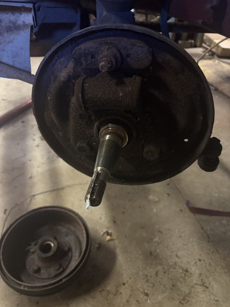

I can honestly say I never thought I'd have so many bits and pieces accumulated to redonthese brakes. Every piece is in a seperate box.

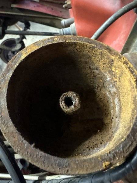

I pressed the old front brake drums off of the hubs this afternoon on my friends press. Just when we thought we were beat they broke loose. One needed a good slug with a five pound sledge.Got the hubs and bearing taking a bath in my ultrasonic parts cleaner tonite.
While I was pulling the left brake backing plate off the spindle I noticed the left upper ball joint is a bit too loosey goosey. Luckily most of our race cars use Mopar uppers and lowers so I hunted down four boxes of new ball joints unused from my last late model project.
The race cars usually use a low friction joint but I'm poor and just use regular production ones. They will be fine in my beater. Only doing the uppers as the lowers are fine. Mow I have to dig out my ball joint sockets.
The process continues this week.
