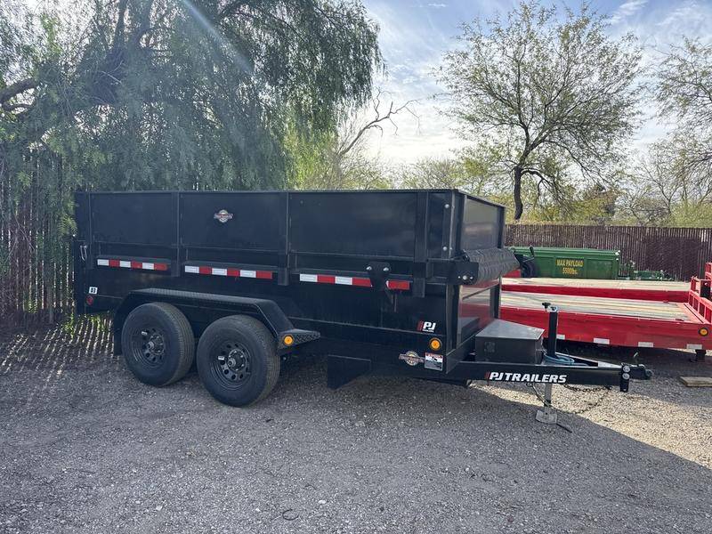

Ok, found this near you. 6500lb put some of the load in truck bed and the rest in this.
Hopefully you have a brake controller.

Or a landscape trailer. That same place in Tucson has one with surge brakes that has a 5500 lb capacity. Put 1500 or so in truck bed. $65/day, done. Why worry?
