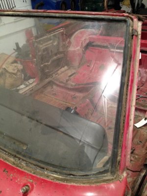

Hello Folks,
Yet another chance to help with a problem that I am having with Sassy the 66 Coronet Convert. Here is a Pic of where I am. So, any Coaching on how to remove the Windshield from here?
Thank you in advance,
B.
Cut the gasket and it'll come out.
Take a razor knife, extend the blade and lay it flat on the glass cutting "the top" off of the gasket. Run it along carefully not to scratch the glass or nip your fingers! I hope they repop them as I did this too!
piano wire works the best for the old butyl seal,poke it through a place and saw it out
Had a "glass removal specialist" help me with my 68 Coronet. He had all the tools and went around it several times and still busted the front window when he tried to push it out. Age, hairline cracks...who knows, but am now forced to get a new windshield. Can't say i am that broken hearted as I probably needed it anyway.
Yep, cur the brittle old gasket as flush with the windshield, as possible on the same plane.
Might want to put a couple layers of thick tape around the border where the knife will slide.
After the 1/2 of the gasket comes off, then run your piano wire/guitar string, etc.
Should be much easier without that outside 1/2 of gasket.
What ever you do, don't torque or twist the glass corner to corner. (it's easier than you might think)
Also be very careful how you store the glass, especially if the climate is going to cycle through hot/cold.
I've had one pop just because it was not supported properly. Best is to store it perfectly vertical IIRC.
You might also want to make sure the glass (and gasket) isn't different for a vert versus a 2 door HT.
Thank you again to everyone. It seems that "take it slowly" if the correct option. Time is our friend.
