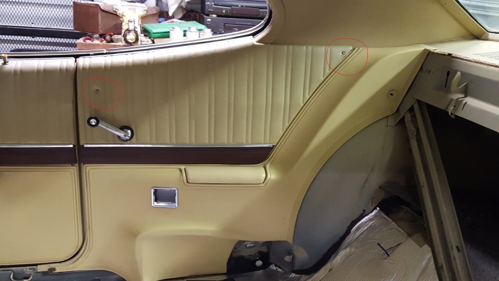

how do i remover the inside rear quarter panel trim?? i see 2 screws and the window crank, took them out, panel still wont move??? what am i missing ?

ok, question, when you say bottom, are you referring to the bottom of the whole thing ( the plastic part ) or the bottom of the upholstered part?? sorry, not trying to sound stupid, i just dont want to break anything !

that would be awesome ! this is all original interior, i dont want to break anything, but i would like to remove them, clean good, insulate and put back

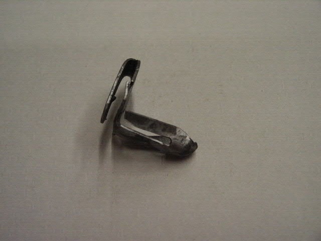

The upper panels should have 4 clips that hold it in place. Typically they look like this.
The lower panels have clips that look like this.

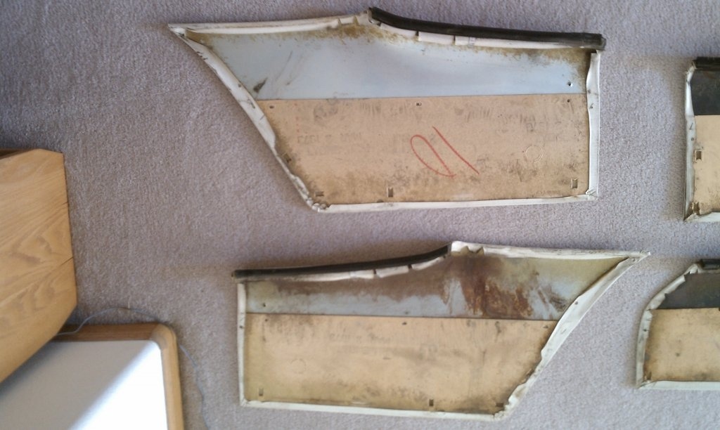

Here is what the back side of the upper panel looks like, where you see the slots along the edge is where the clips in the first picture go.

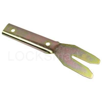

A removal tool is your friend as its best to get the pressure to pop these as close to the clip as possible, especially if they haven't been removed in years because they can tear through the fiber board backing. Here is the tool I use and available from autozone.
I find it best to start with the one in the lower front corner where you can easily get the tool in from the door jamb area and pop it, once that is done you can move along underneath to the middle lower one, then the back ones, use even pressure, and don't jerk on the panel, that can cause tears in the fiber board.

You can do it with a screw driver, but you have to be super aware of where the metal of those clips are to pry against, otherwise the cardboard is likely to rip. Still possible with the tool, but less likely. Good idea to pry on the metal even if using the tool.
