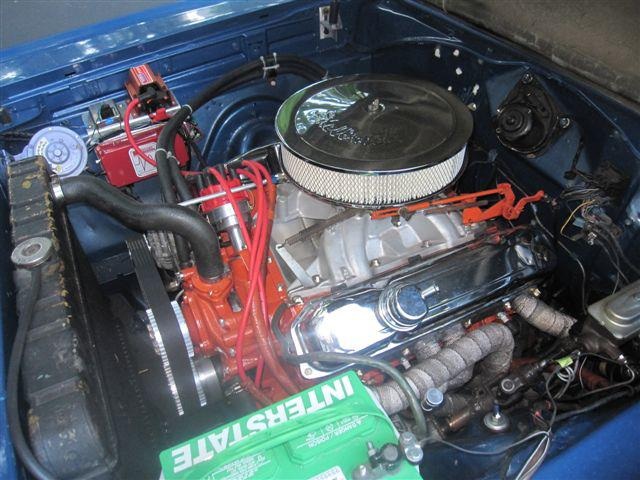

No worries, it's all under the dash and pretty easy to access. The only thing not under the dash is the wiper motor, which is in the engine compartment (big black thing on the fire wall right behind the air cleaner).
Sounds like they're not going in the park position. That's in the motor, not the linkage.
