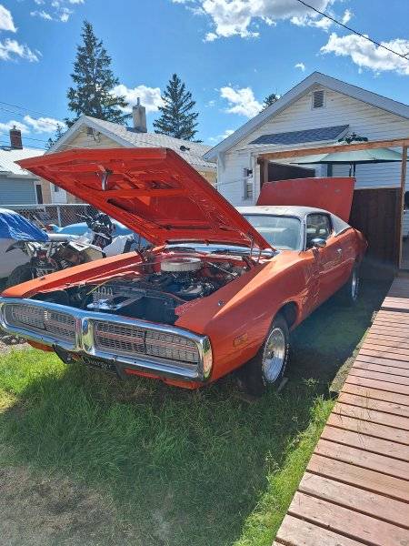

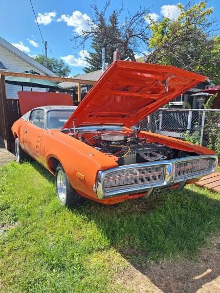

I am in the process of negotiating on a 72 charger. The car is a bit of a Frankenstein, at the same time it has a lot of potential. The car currently comes with a 400 / 727 combo with 3.91 diffy.
The goal is to make 425 hp/500 tq on pump gas. I also want to run a therm-quad as well as HP exhaust manifolds., this will be a daily driver sort of deal. I am going to swap the rear gears to a 3.23 sure grip.
I would like to hit 9.5-1 compression, not sure if i could get away with warmed over cast heads, or if 440 source aluminum heads would be better. I want the engine to look stock from the outside. As far as the cam goes? Will a cam under .500 lift get the job done.
If not, then i am not apposed to making it a 451 cubic inch with the same concept. Should be easier to hit the numbers with a larger engine.
Please post some combos etc to point me in the right direction, I have had performance builds in the past that were a pain to deal with and live with on the street. I am 62 yrs old now and just want a nice car that will dance when i stab the gas on the highway to pass someone. lol

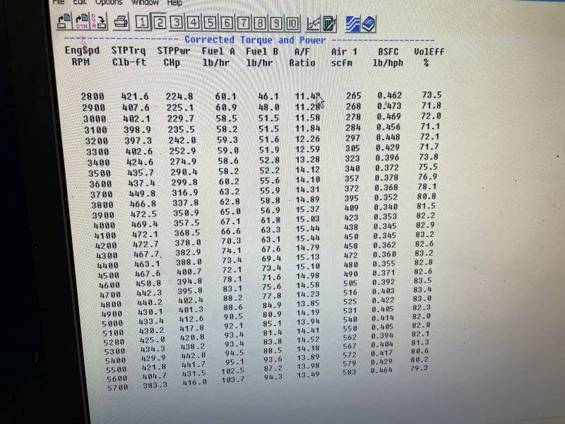

I made 415 HP and 450 TQ from a stock stroke 400 with about 9:1 compression. I had ported stock heads which flowed about the same as the Stealths . It used a 222/234 cam. More cam would up the horsepower but not necessarily the torque. The stock exhaust manifolds and 3.23 gears are not going to work well with that combination. A 451 will get you to your torque goal with less cam and will work better with your intended combination.

Sorry, that's just not true. I built a 383/438" 9.3:1 stroker for a friend with untouched "OOTB" Stealth heads that made around 450hp/475lb ft of torque with a relatively mild Hughes cam. Headers, Performer RPM intake, 750 DP carb. OK, it had Comp Magnum roller rockers... "Mineshaft" air that day, the dyno actually took away some power. Hydraulic roller would probably be another 25 hp...
This engine went in a 100% street/highway cruiser C body and the guy loves it. It's the most power he's ever had under his right foot.
