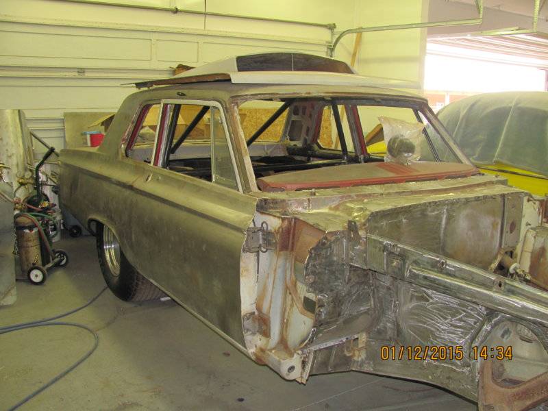

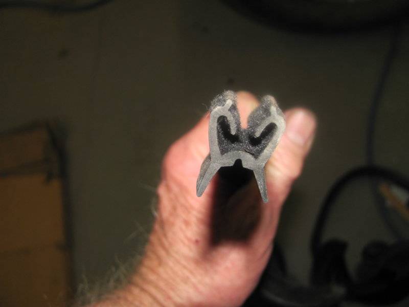

I have a 2 door post car that is being built as a AFX Pro Street car . Finally getting to install tubs and will have to put windows in and installed before tubs are put in place . I have new 1/4 window seals and window track rubber but the old stuff is in a track that pinches it real tight . Has anyone replaced this in their car and what is the best way to do it . The old rubber and the new look exactly the same with rubber wings in the back . I could cut the old out but how do I put the new ones back end .

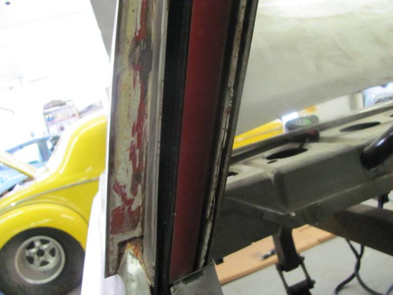

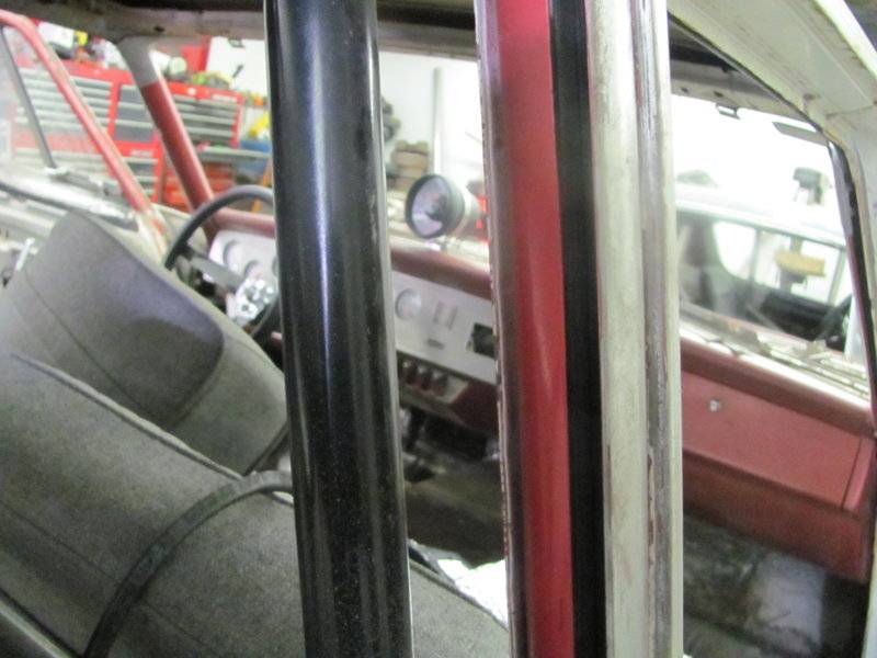

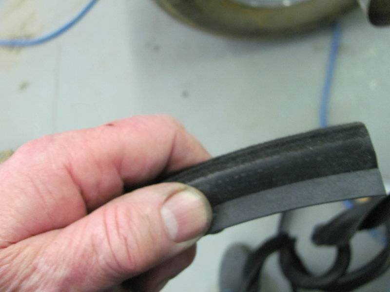

Well after 2 days and 85 views with no answers I took a leap of faith and cut the old rubber track out . The top of the old rubber was cut at a 45 degree angle to mate at the top of the track . On the front there was a tab that held the track in place , I bent it back up and cut the new track on the end , it slid back into the window rail . to seat it was it was pushed I used a small nail puller end to set it down as I pushed it up . The curved back piece went in well but had to be seated several times with small end of the nail puller I used . So all is well and I am moving forward with the car .

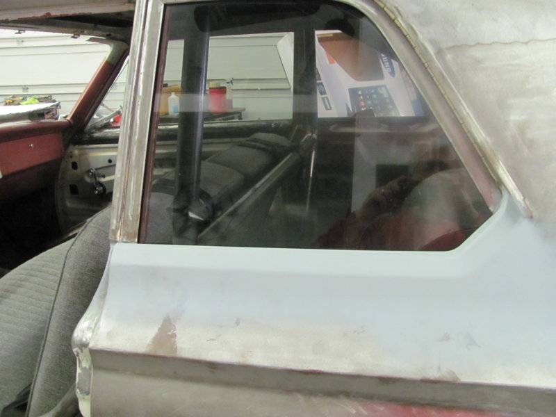

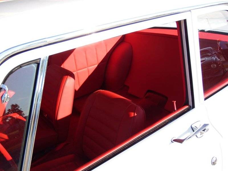

This is what I was looking for my windows and how I did it . After putting the new window track channel pieces in place , I took the windows and had them tinted to 35% . I have always felt that this gives the car a better look . Plus look where I live AZ. HOT. In the news paper one day this was printed Arizona weather is 3 months of heaven and 9 months of Hell and Hell has just arrived !

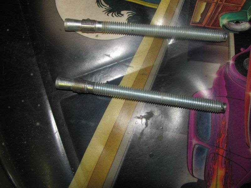

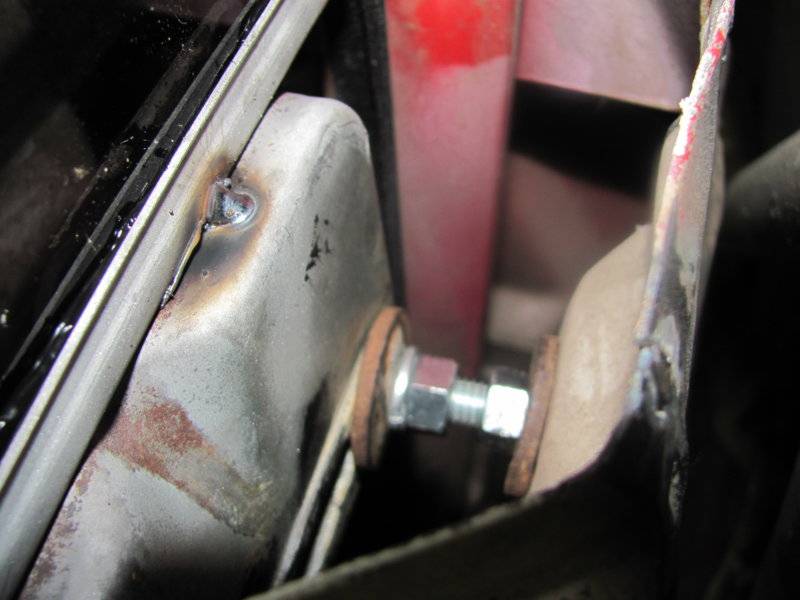

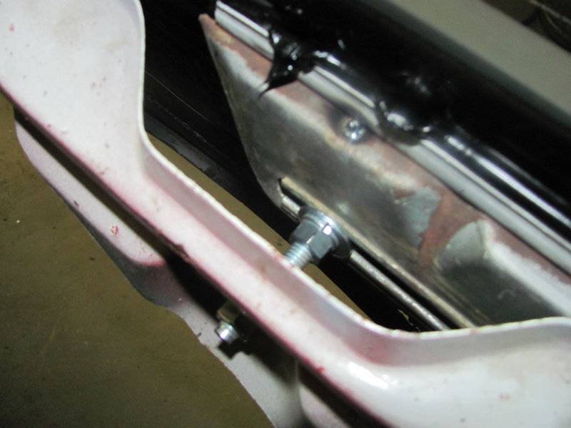

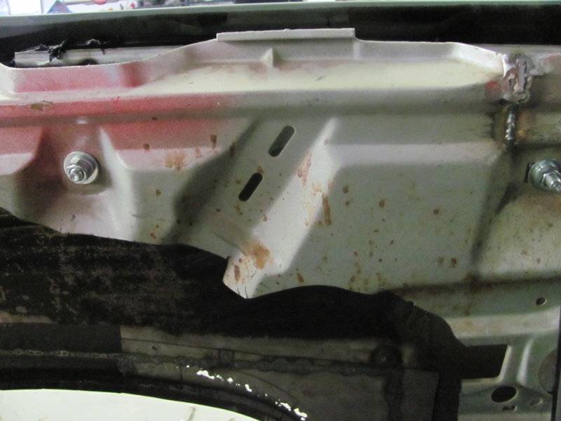

I put the glass into the new tracks and then had to figure out how to keep it in place , first I drilled out the spot welds on the old window track and was going to make up a rod to hold them but changed my mind after having a talk with my self , and yes I talk to my self . I welded the two pieces back together and held it up to the bottom of the window . I saw that there were 2 holes that lined up perfect with the slots in the lower frame piece and were recessed . I found some concrete studs that was left over that were 3/8 inch threads ( I am cheap ! ) . picked up 3/8 nuts , flat washers and lock washer . Spaced them out and kept fitting them until the lower piece was under the window then cut off the extra that was not needed . I used window shield adhesive to set the window into the lower track and installed it . I could use the nuts on both sides to adjust the bottom in or out . Pic's of studs and how the window is held in place and how it looks . Thanks to every one that answered me .Thanks John
