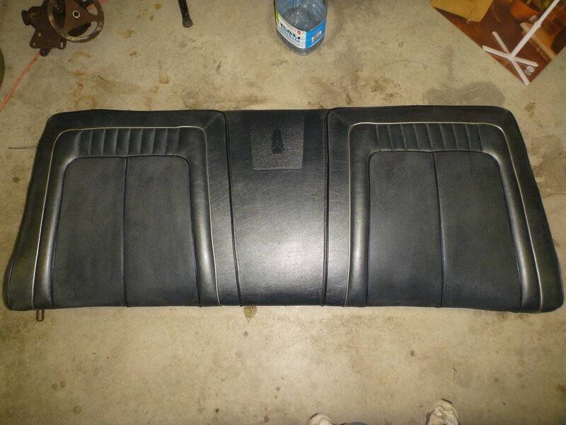

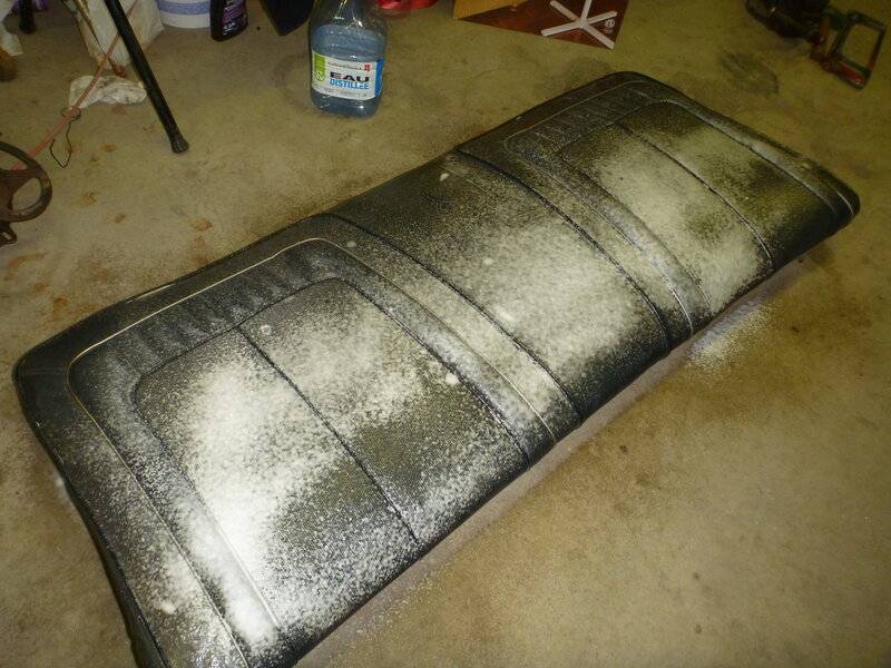

Did the Bird's right in the car, spray can of upholstery cleaner..
Scrubbing bubbles for showers on the seats and vinyl roof and use the little plastic bristle brush from the upholstery cleaner can to work it into the grain. Best I've ever seen/used. I've tried many things over the years and they always went right back to looking gray. Seats and top are still Black as the day I cleaned them in 2019.
