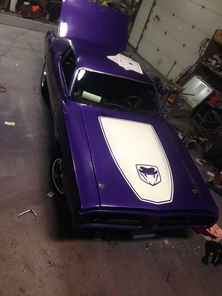

Hey guys, when I bought my Charger, all of the door glass was smashed, and now that I'm ready to install it again, the hardware still remains, but I have no idea how it goes in.. After about 8 hours of messing around I finally figured out how the Quarter window glass goes in, and I took it apart!
Any advice will be surely appreciated.. Car pic to get noticed!
