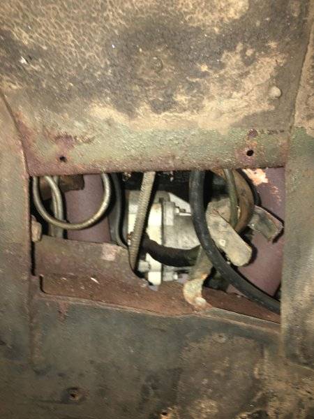

I'm in the middle of doing a power front disc conversion on a 1969 Coronet 500. I'm using Dr Diff's stage 2 kit. I'm at the point where I need to replace distribution block with his. The car is on jack stands and access is very limited. How do I remove the distribution block? It doesn't look possible.
Thanks for any help provided.
One bolt holds it to the frame rail..
Thanks dadsbee.... it's getting to that bolt and lines that is the problem. With engine, headers and steering column in the way it looks like a PITA to loosen lines and remove.
See that big hole where the flap for front end adjustment is try go in from the out side. Remove tire, the bolt is to the rear of distribution block, enlarge dadsbee's handiy picture.

I went looking for that hole...the shield was covered with rubberized under coating and I missed it.
Should I remove the lines first or does removing the distribution block from frame make access to lines easier?
Might loosen them, then try by hand. When you put them on whatever block you use don't bolt down block! Get the lines started by hand 2 turns before you wrench them. I speak from experience a bad one.

Removing that shield... don't think it will help.

Tighter than I thought. Do you think you can unbolt D bllock?

It's starting to look like I will have to leave it alone. If I can get it drivable maybe get it to a lift.
Probably have to hold off converting power booster so I won't have to change mc lines.
