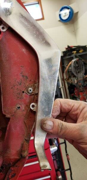

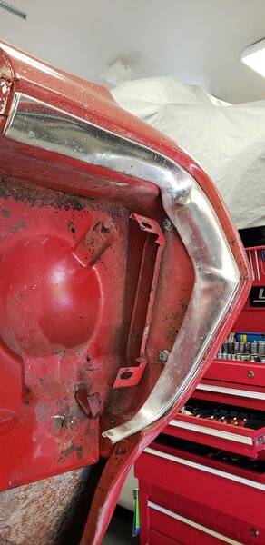

I'm really struggling trying to figure out how to get the eyebrow trim off of my 64 sport fury. As you'll see in the photos there's a slide clip on the vertical piece but there doesn't seem to be any way to get at the horizontal piece at the top. I have another sport fury that has a bit of a loose eyebrow trim and I can see a threaded stud going up through the top of the molding through the body. but I can't see any way to get at it from behind. Any help would be appreciated.

Pull the front splash shield and you'll be able to get to the bolts! it's not the easiest job but it can be done The only other way is pull the fenders!
