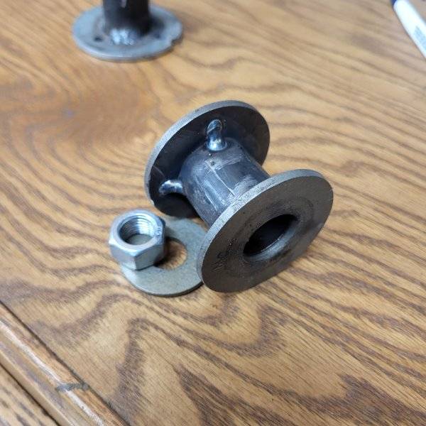

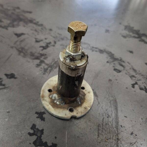

I took a few minutes and made one, didn't bother taking the time to make it $75 pretty, but it works just fine.

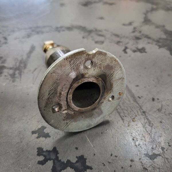

Screw it down. Put the snap ring on the shaft. Put the nut on. Get a helper to pull up on the shaft lightly while you tap the inner race of the bearing. It will not take much to expose the groove. Pop the snap ring in place.
