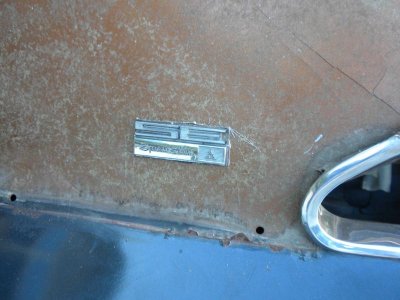

SE Emblems -- there appears to be no way to access the panel to pop them off. How do you remove them without breaking them off? We're not going to put them back, but we'd rather not destroy them either.

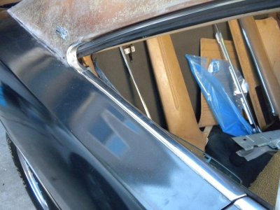

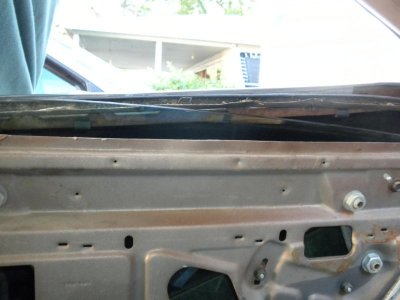

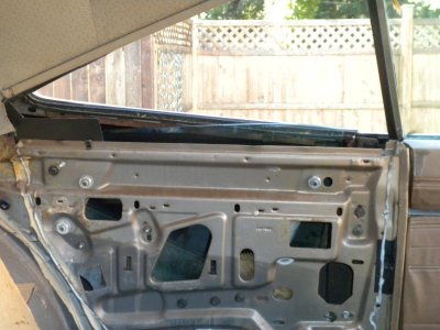

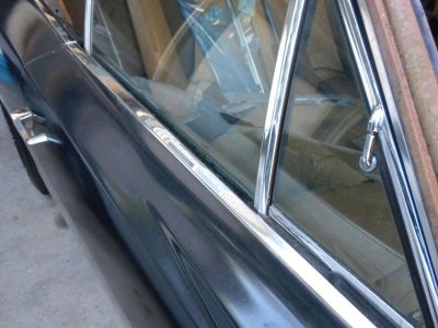

Window trim -- we don't know how to remove the curved trim piece at the bottom of the rear window (which appears to be glued/cemented in) and the piece next to it along the rear window and also the piece along the top of the door. These trim pieces don't appear to be held in the way most trim is (we were able to remove every other trim piece). How do you remove these pieces without making them un-reusable?!
You will have to pull the headliner loose to get to the nuts that hold the medallion on! I believe the trim is held on with wire clips, should be able to pry them up with a flat scraper!
