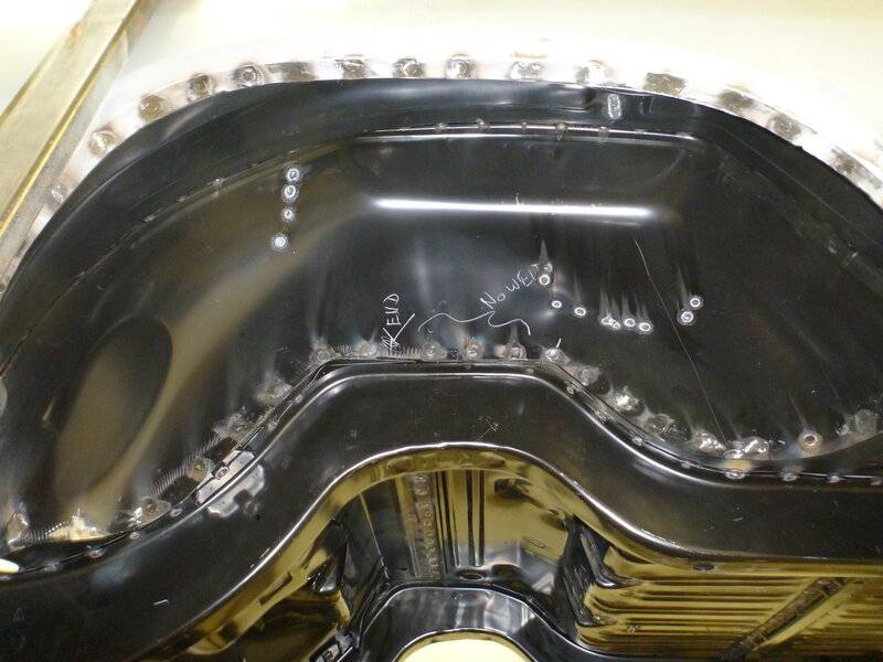

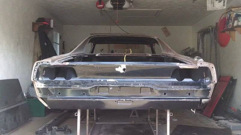

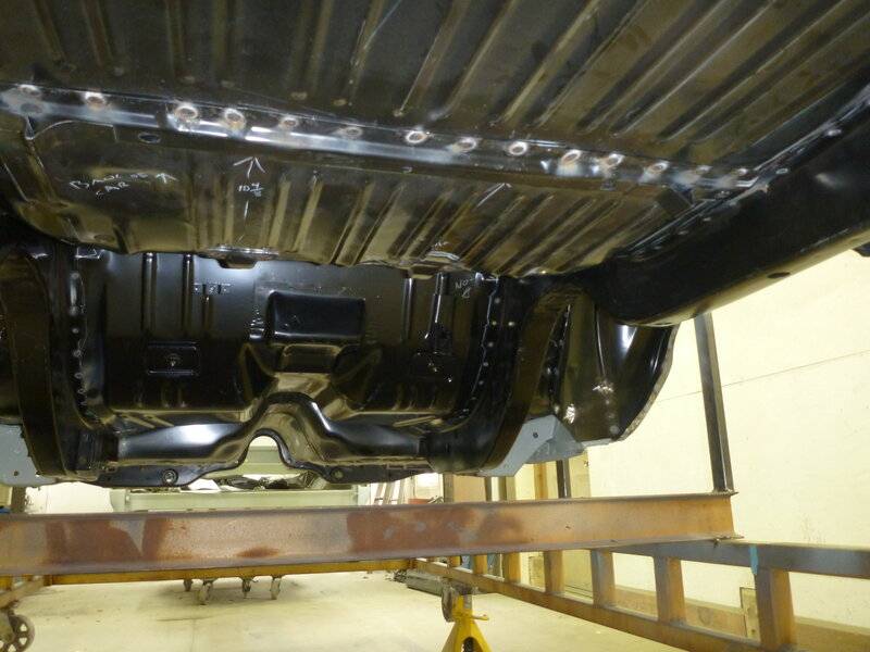

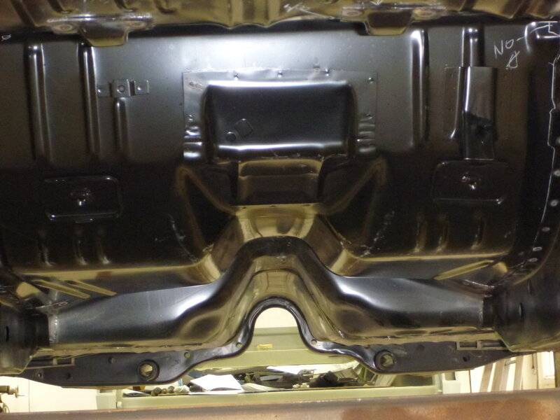

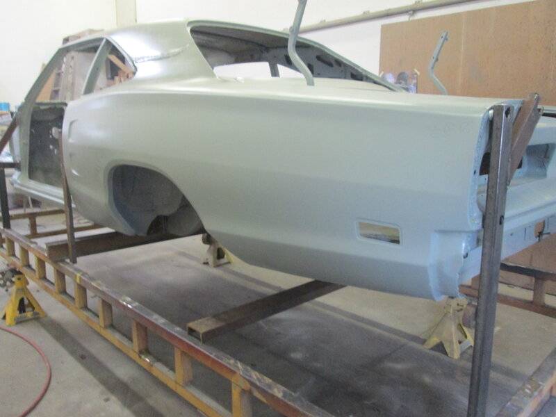

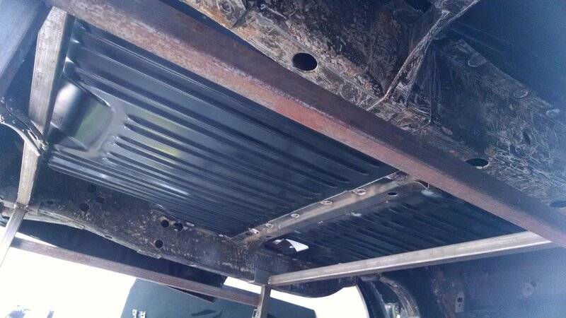

What car are you working on. I got lucky all frame rails where good on my car. I would measure form my drop downs and wheel tub's. Measure between them. Do one at a time. That sound's like a real job. If you can get pic's of it let us see what and where your going to be doing the work on the car. I did one piece at a time on mine did quarter replacement- tail light bucket's- valance panel and all on this runner. New trunk pan. Got lucky the rear seat pan was in good shape. The hole back of the car had to be replaced even the filler panel between the quarters and all the back window stuff like package tray.

Sorry Bad B-rad. I got my welder from East Wood. Used Argon gas type welder and bought a tig on E bay. The Mig is from East Wood. East Wood sell's a tip for the Tig. that you can do spot welding with out having to drill hole's and weld like the Mig. It take some practice is advised with some scrap metal pieces. The metal need's to be clean and use weld through primer.
Yes Dad'sbee you did some good work. Know the welding is not the hard thing. But all that grinding and drilling holes is the most work I can think of. I mean that grinding dust is a killer even with a mask on and goggles. It get's every where. :lol:

THe back of the car is in a very bad shape.... all the the parts need to be replaced.
Rear crossmember is half rotted away.... also like the rear valance and trunk panel.

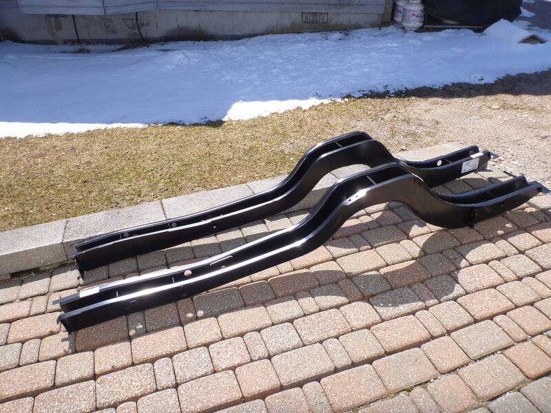

I already do have the full frame rails from AMD..... but actually the frame rails are in a good condition at the front.

Just to say I don't like to patch frame rail's together. Just my feeling. Would replace the hole thing. Did patch an outer rocker on my passenger side on this car. But I bought the hole rocker and cut it longer than I needed and it slipped behind the old one like a patch panel. I did by a pinch welder 220 volt from harbor freight it came in handy in some place's but the tong's are not long enough to reach some area. Wish ya luck and have fun.
hy and thx again for ur advice...
i feel also better to swap the whole frame rails instead of patching..... just thought to keep as much as original, as often recommend and also to have it a bit easier.

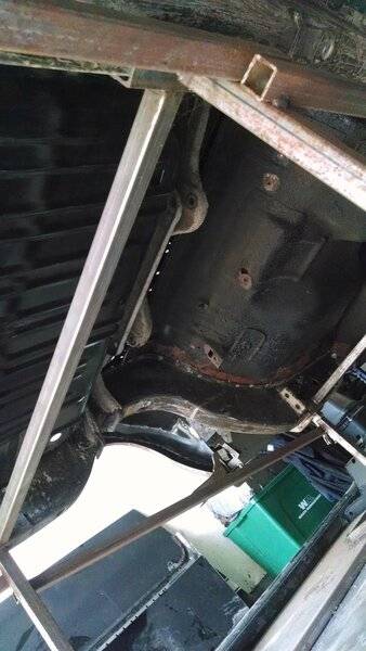

I replaced the rear rails on my 68 Charger. There were pinholes at the rear but I decided to replace both entire rails with original southern frame rails. I leveled the car on jack stands then built a fixture out of 3/4" square tubing that I welded to the car. I replaced one side at a time and everything lined up nicely. I also did the trunk floor and rear cross member at the same time.
thanks for ur advice... do you have any pics about ur setup ?

Sorry I don't have any good pics, but I made a rectangle perimeter on the floor, then I made pieces that go up from the perimeter piece to the car. The very front pieces I welded to the rocker pinch weld and I had two additional pieces on each side that went up and met the frame rails. I welded a piece of angle iron that cradled the outer corners of the rails and clamped them. Then I just added cross pieces from side to side and front to back to stabilize the whole setup...
