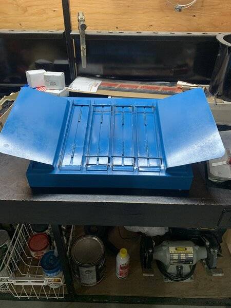

@marty mopar I have a counter top parts catalogue rack and I'm looking for catalogues for my cars to put in it, particularly 68 and 74 cars and 78 and 83 trucks. I've seen pictures of bound catalogues. How long were these made and when did they switch to the big blue loose leaf binders? Will it work very well if I just put the loose leaf pages in the catalogue rack?
