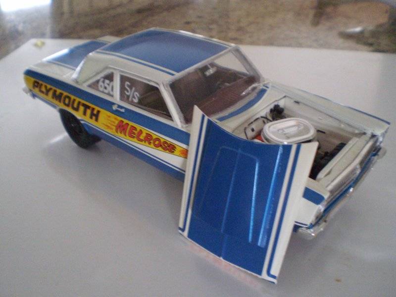

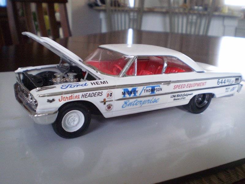

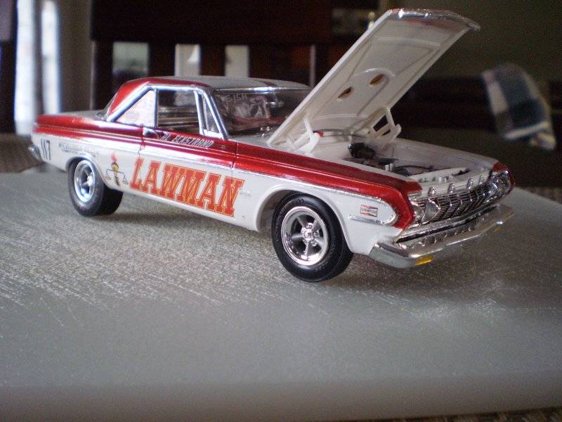

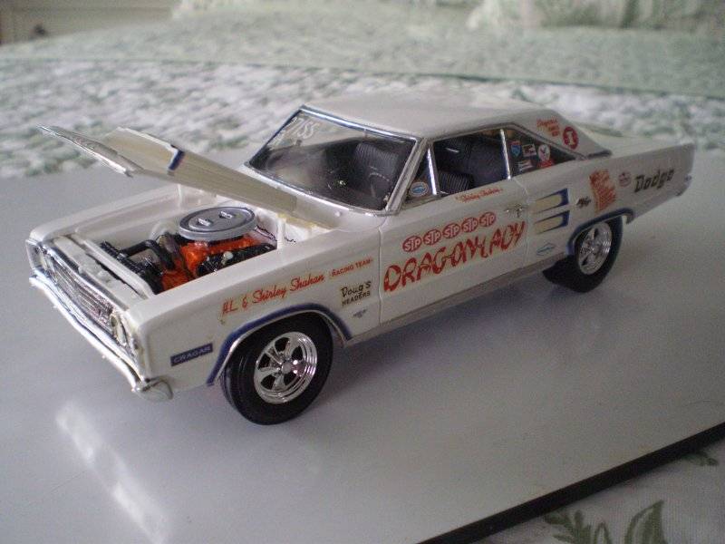

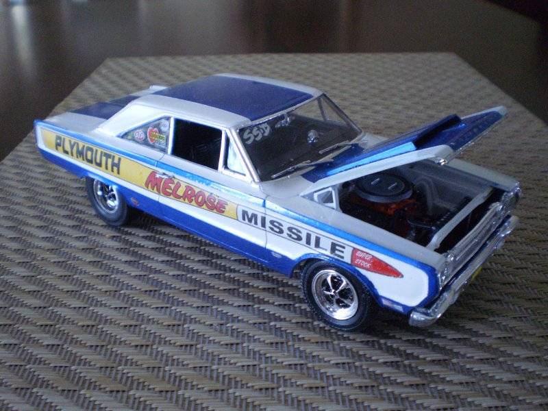

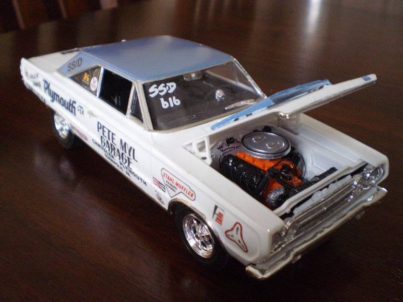

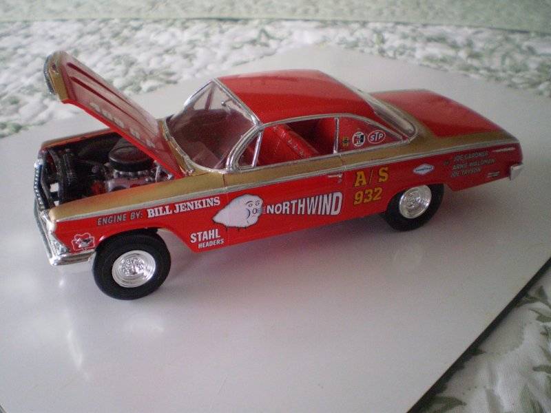

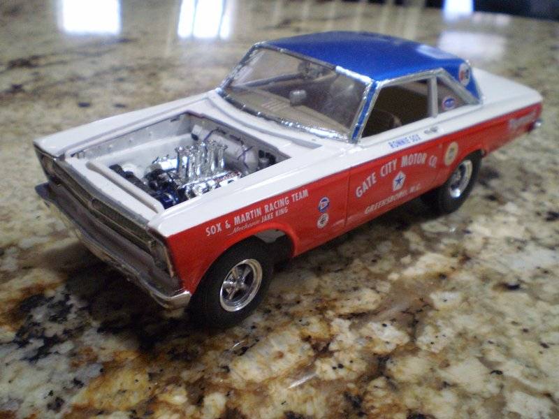

Here are some of my Super Stocks.

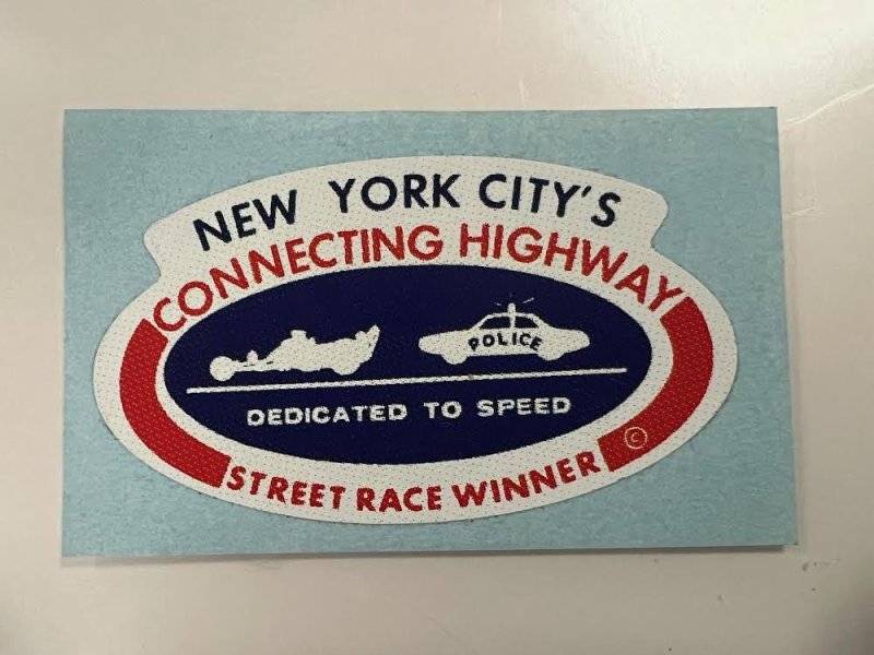

Here's the first one. The infamous Connecting Highway. It was a place of lore and legend. 1 to 2000+ spectators on any given night. Probably the most active street racing haunt in the country besides Woodward.
It's a real deal water transfer decal from back in the 60's-70's. Two of these will be applied to the quarter windows.
The car saw action there way after the heyday, but nevertheless, saw action.
Here's a current day replica sticker, not a decal, but a real fake. Colors are off and so is the type of paper and cut out. One can see the holes in the sticker. Not my cup of tea.
