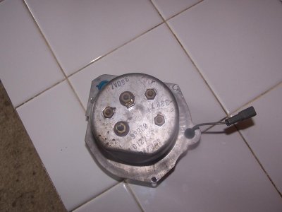

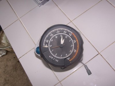

how to wire tic toc tach?
99ss
3:15 PM
Jul 15, 2010
2,210
470
Oregon
grey wire to coil?
is the terminal for power? the assembly grounds itself to the dash fram correct?
TIA
Hello, I just wired my Charger with the Tic Toc Tac. The dash frame is the ground (-), the long screw on the back is the power for the tach, which would be the blue (+), this goes to the fuse block. The gray with the red tracer goes thru the firewall and to the negative (-) side of the coil. The gray wire sticking out with the terminal is power for the clock. Hope this helps.

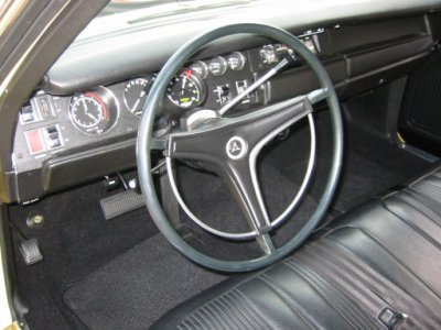

Is that the dash-worx kit? I see they have a kit for the clock as well and ammeter..
Yes, I have bought a harness from Dash-Worx, they have a kit for the clock and tach. You could also buy a new board, have seen those on Ebay.
