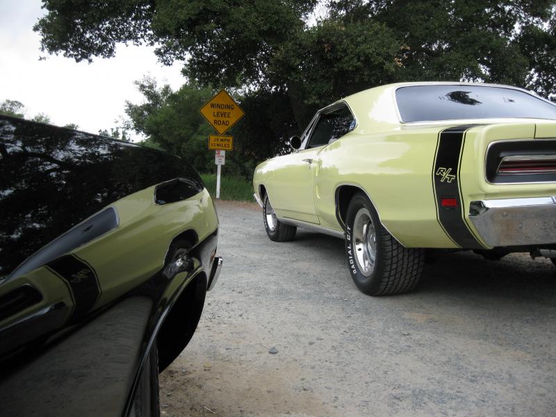

69 Coronet. 225 70 14's front. 295 50 15's 8" rear. SacRanchoCordoovaJune22,2013 020.jpg Cooper Cobras. Road car. Feels as good at triple digits as 70.
