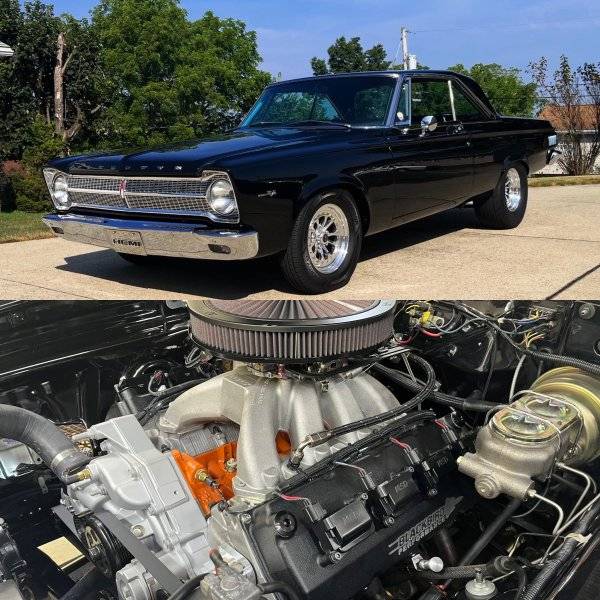

Hello, I have in my shop a fully forged 6.4 hemi built using a BGE block, Billet steel caps and ARP main studs, Factory forged crank, Molnar PWR ADR rods, and CP 2618 pistons that will put it right around 10.5:1 with Apache or Hellcat Heads. If Eagle head will work, which I am not 100% sure of, the compression ratio would be closer to 11.6:1.
I would like to finish this engine and get it into a 68 B body. I am OK with it being rowdy, not looking for a factory 6.4 experience.
How would you guys finish it off? Boost? Put the eagle heads on it and a big cam and make a poor man's drak pak copy?
Thanks for any advice/help.
What is your vision for the car? How to finish it depends on what the car is to be used for. You don't want an engine that won't idle properly, stay cool, etc. in a street car.
