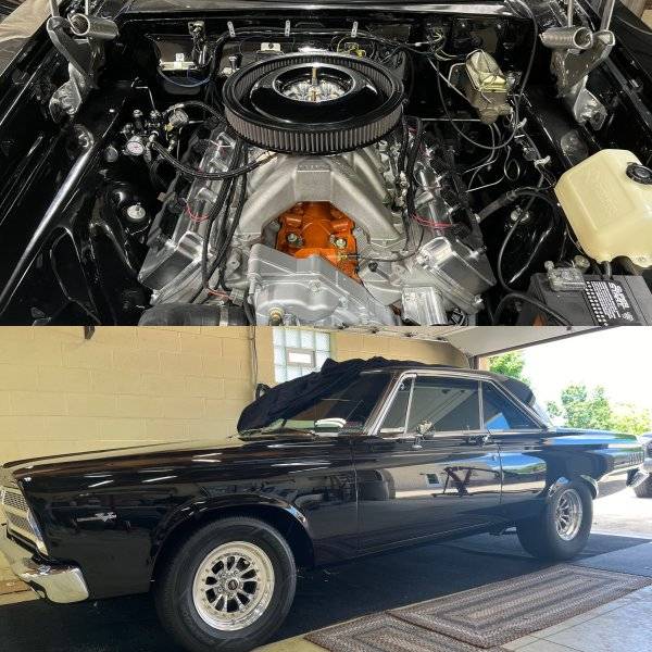

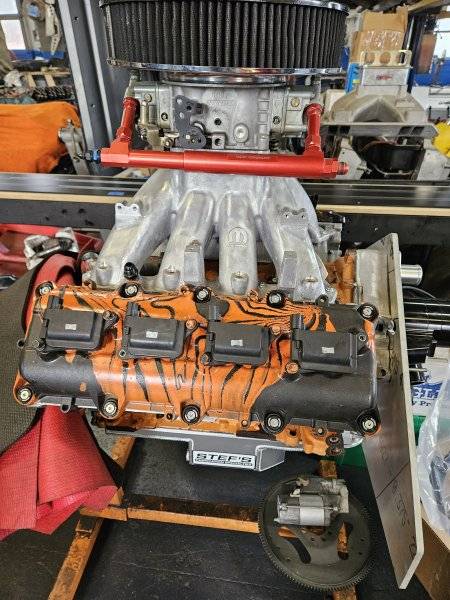

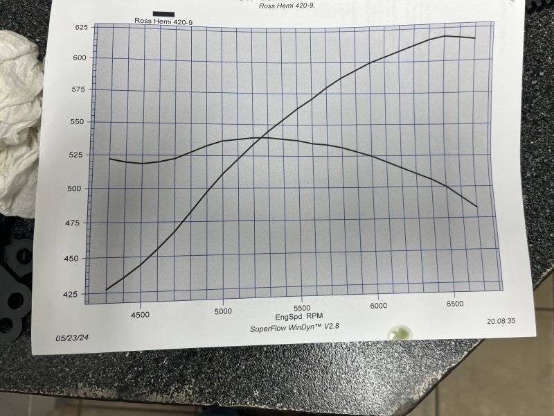

6.1 block stroked to 426 Molnar crank and rods Mahle pistons
Eagle heads ported
10.9.1 compression
Cam is 239/251 583/583. 112+2 centerline
Prefix intake and a 950 carb
Msd ignition
Assault water pump
ATI balancer

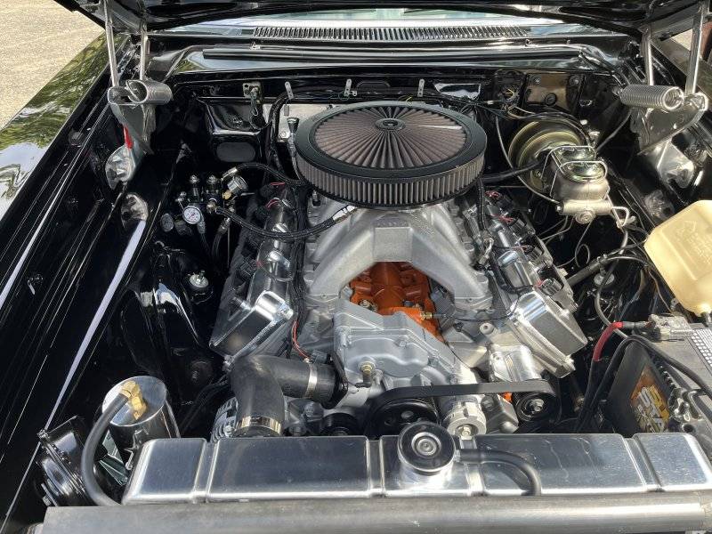

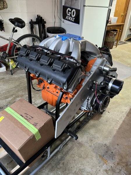

My build:
426ci build for boost, single 88mm turbo. This will be a street/strip 66' Satellite.
6.4 BGE block, ARP head and main studs.
Manley 4.050 4340 crank
Molnar PWR ADR 6.125 billet rods (2.00 rod journal, .927 pin, ARP2000 bolts)
Mahle 2618 forged pistons with gas ports (1mm, 1mm, 2mm ring pack)
ATI 918453 balancer
6.4 BGE heads CNC'd by Livernois (390cfm @ 600 lift with 2.14 valve)
Manley race flow valves
Cam will be custom grind from joe Greene racing.

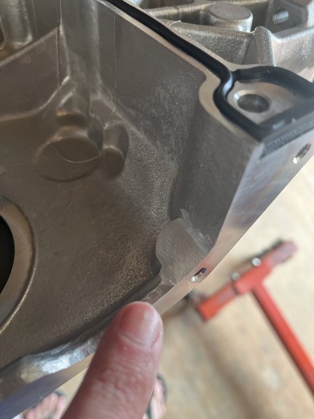

If you plan on using a Melling HV oil pump for Non-VVT engines the pickup tube will interfere with a factory Hellcat timing chain cover. Slight grinding of the oil timing chain cover will allow it to fit.
