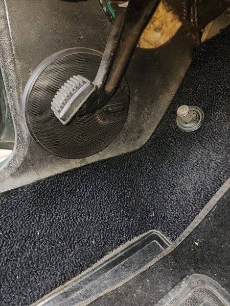

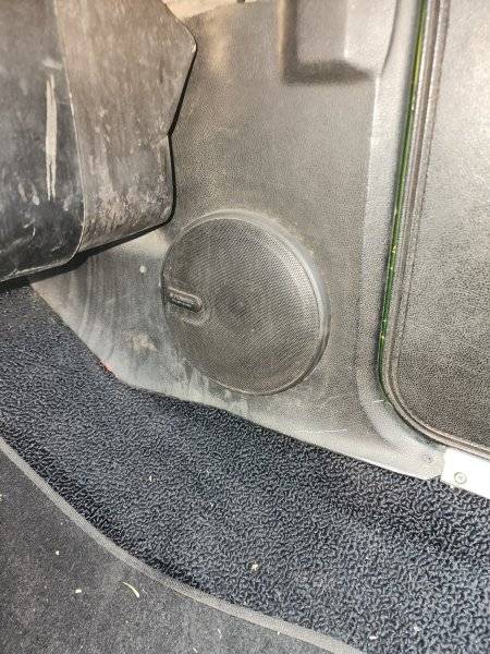

I'm ruminating on the same kick panel speaker project.

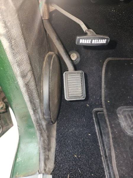

The E brake pedal travel is extremely close on the driver's side, severely limiting the depth useable for mounting and thus also limiting the size and style of speaker.
Right now, my plan is to bolt a plate to the framing in order to utilize what mounting depth is available below the panel, and then use a shower drain as a guide to drill holes in the panel, so I don't have to use speaker grills that sit above the panel.
So far, the largest speaker I've tried the clears everything is a Pioneer 5 1/4, but the frequency response of that is not really up to what I'm looking for.

Hmmm, did you bend that brake pedal out of the way?
Mine is literally right up against the panel.
They were installed when I got the car. Since its got a cassette tape deck in it I figure it was installed in the 80's. I'll have to take a closer look when I replace the kick panels. The E- brake works properly though.
