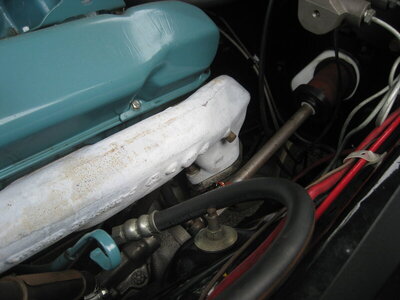

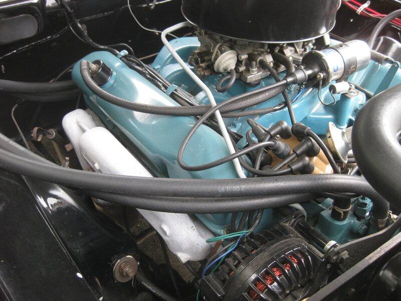

I put them on the 361 in my 64 Fury. Same dimensions as a 383. Absolutely no problems.

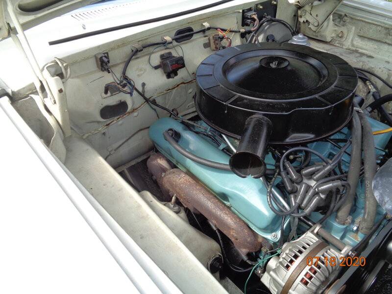

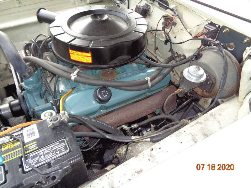

I have a 1971 /383 in my 62 Polara 500. It currently has some unknown brand headers on it. I would like to install 70-71 HP exh. manifolds on her ...BUT it still has the 1962 power steering pump. It looks HUGE! Will the HP exh. manifold fit on that drivers side?????? Thanks very much!!!!!!
No problem with that combo.
383's are an inch smaller in width than the R.B.s so there is more room between the heat riser and the shock tower! I have less than a 1/4 " clearance so no counter weight!
