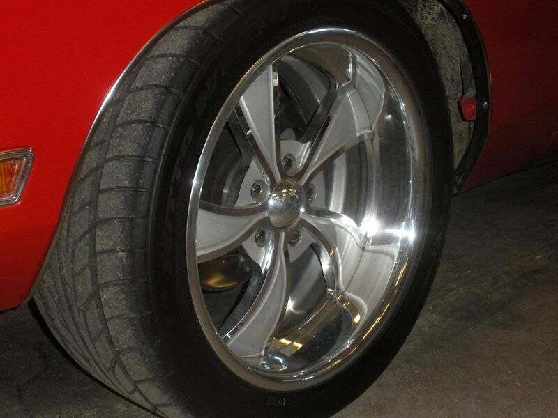

The wheels on "Ginger" are lug centric and I've been to 130 or so with no bad habits. I had a '78 Trail Duster with original 8 spoke wheels and they were lug centric.
Centered should be centered regardless of how it's achieved.
