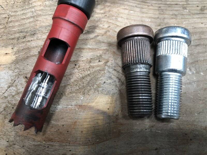

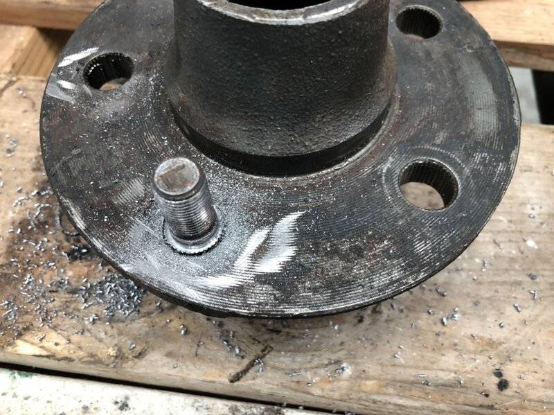

I didn't drill out the centers of mine, I just cut the knurl off with a 5/8" hole saw. Take the drill bit out of the hole saw and clearance with a grinding stone or file. It fits snug over the stud. 11/16" hole saw may work too. Drill down about 1/8" or so is all I needed. Then I used a press to get them out.
https://www.amazon.com/gp/product/B06XGWDTX8/ref=ppx_yo_dt_b_asin_title_o01_s00?ie=UTF8&psc=1
519012F7-1AD3-4CAC-A3BD-DB77314BD3D1.jpeg 4FDC9A17-89A1-4681-A87A-4D0ABAF81895.jpeg
