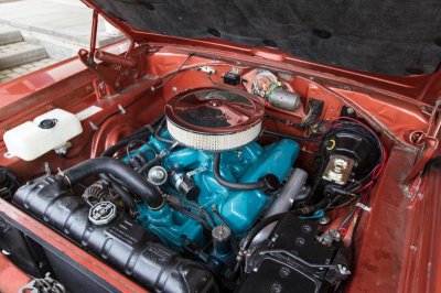

I have a build thread for my car, but maybe some of you want to hear the Hughes Whiplash cam and did not realize I used it in my build. I have the roller cam, so I am using Hughes Engines' CNC'd roller rockers and their roller lifters, the rockers are 1.6 ratio.
Please forgive the metallic clanking noise. It is the unused heat riser assembly which came loose from being wired open. My new manifolds will not have this system, but I am running in with my original factory manifolds. So it is flapping about in this video. And now it is pouring down outside so I have not had the chance to wire it back up.

It is an edelbrock air cleaner, using a drop base. I am not sure of the element size actually. My mate Janne put it on. The plan is to mod a spare STOCK base I have, weld the drop base into it, then for shows I will go back to running my stock factory air cleaner.
The Holley is a 750DP Ultra, and we are using LOKAR kickdown and throttle cables using the LOKAR linkage. I will take some close ups this weekend and post them if you like.
