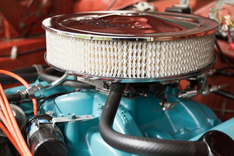

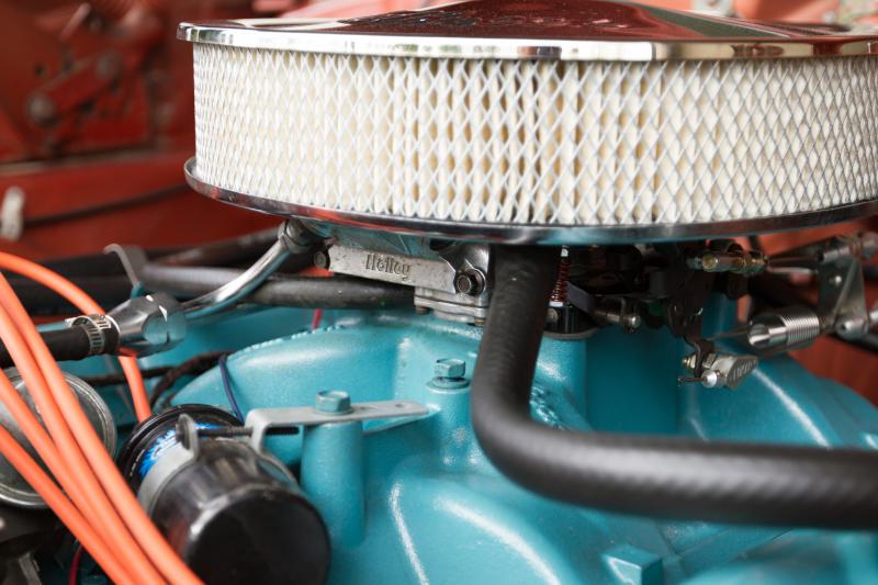

I'm getting questioned about the drop base and air cleaner setup.
I will take photos tomorrow and make some measurements for you all.

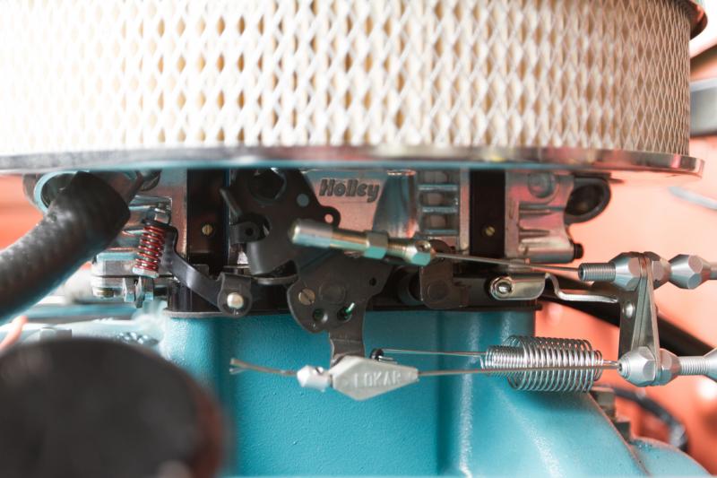

I can say that I changed my stock linkages to LOKAR for both throttle and kickdown. Their setup takes up way less space and meant I could just hook up to the stock Holley linkages etc.

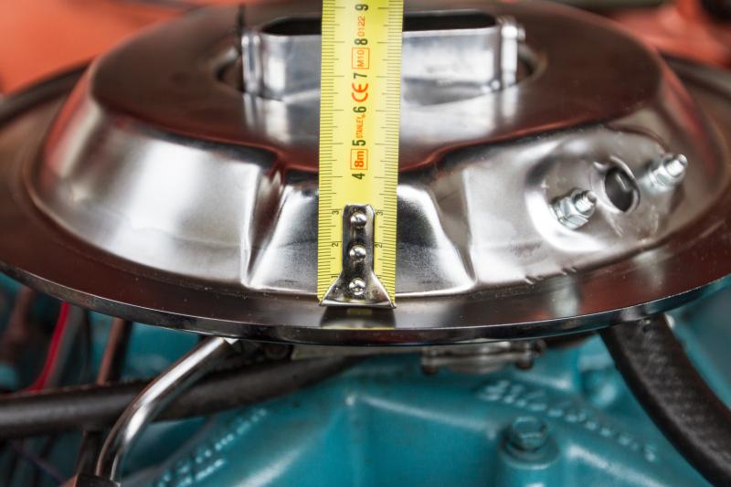

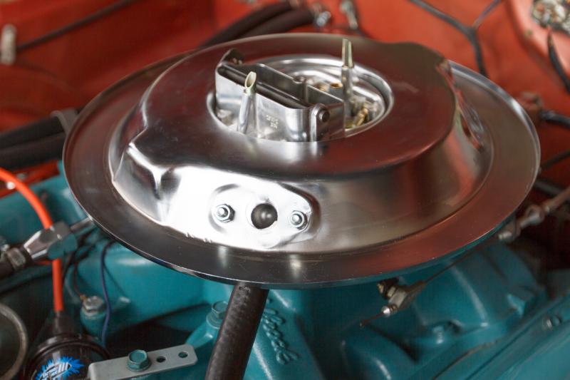

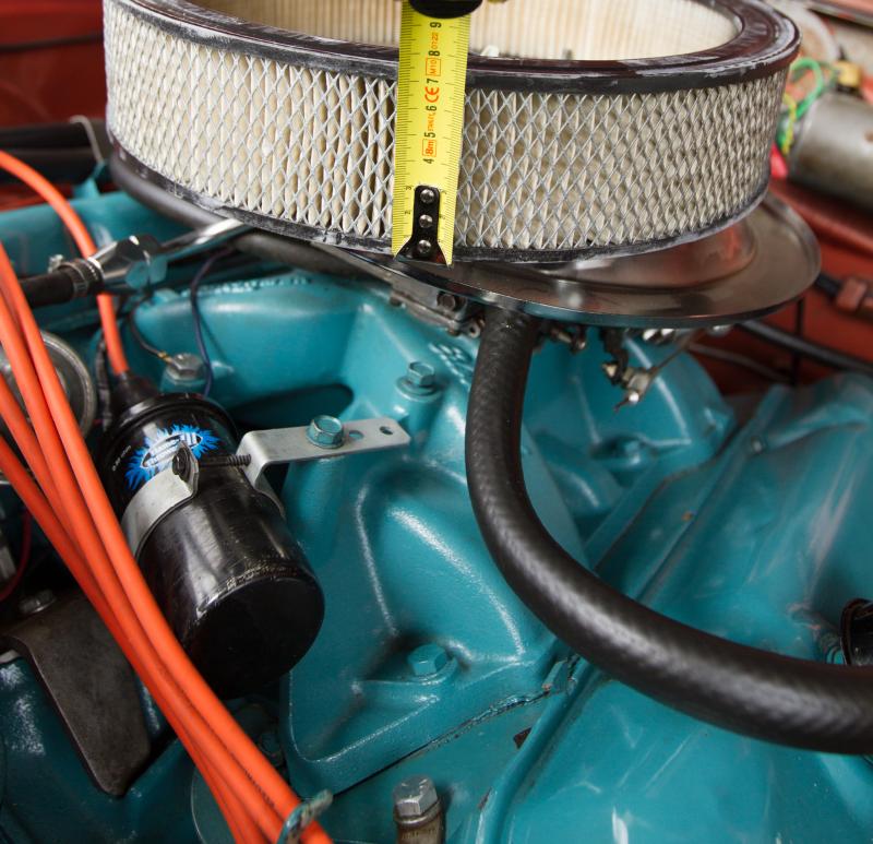

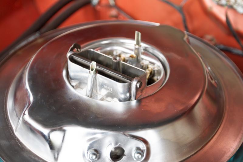

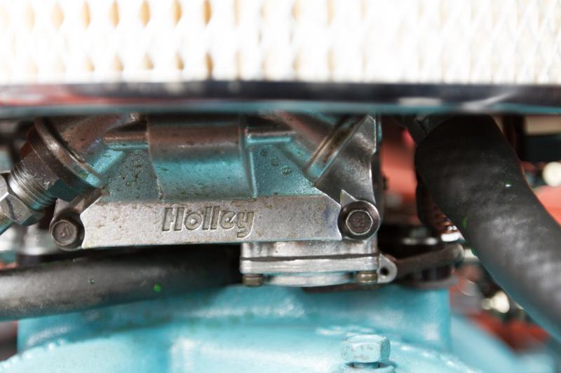

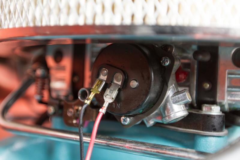

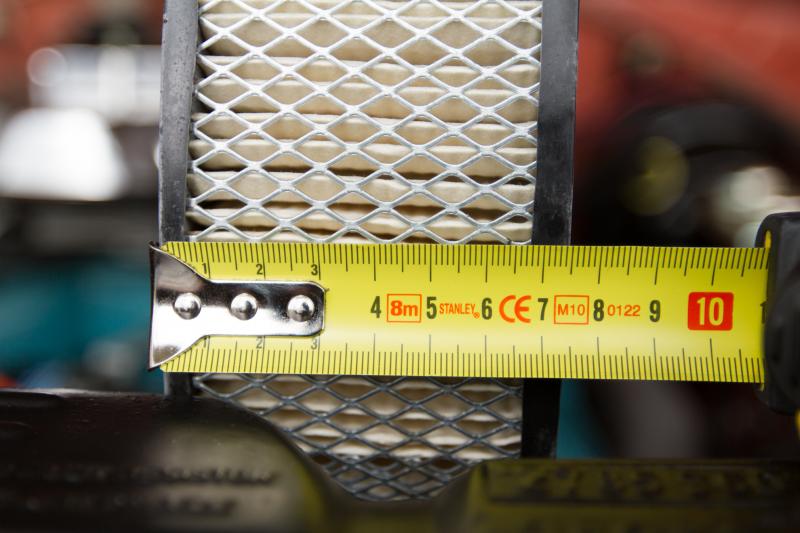

OK,
Here are photos of my Drop base air cleaner etc.
My element is a standard 3" tall 14" diameter one.
IMG_2304.jpgIMG_2307.jpgIMG_2308.jpgIMG_2311.jpgIMG_2313.jpgIMG_2314.jpgIMG_2316.jpgIMG_2318.jpgIMG_2320.jpgIMG_2322.jpg

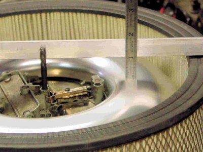

Another Question for ya Tek, Did you flip the coil bracket and cut off the other side of the bracket or is that something you bought ?
I'm pretty sure this is the one you have. http://www.summitracing.com/parts/edl-1221/overview/

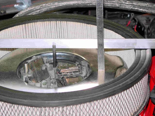

Edelbrock states it's only a 0.625" drop. I suppose they figure if your using a 3" filter you will have 2.375" open.
This is what a 1.5" drop does.. Reducing the open area of the filter to 1.5" 20100922_AirCleaner_0307.jpg
Yep I flipped the bracket for the coil mate. I am going to paint it at some point, but this worked better than we expected so for now I am going with it.
My mate had so many drop bases to choose from in stock, so I really do not know which one he chose. But it looks a lot like that summit one you posted.
