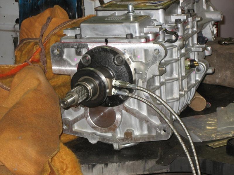

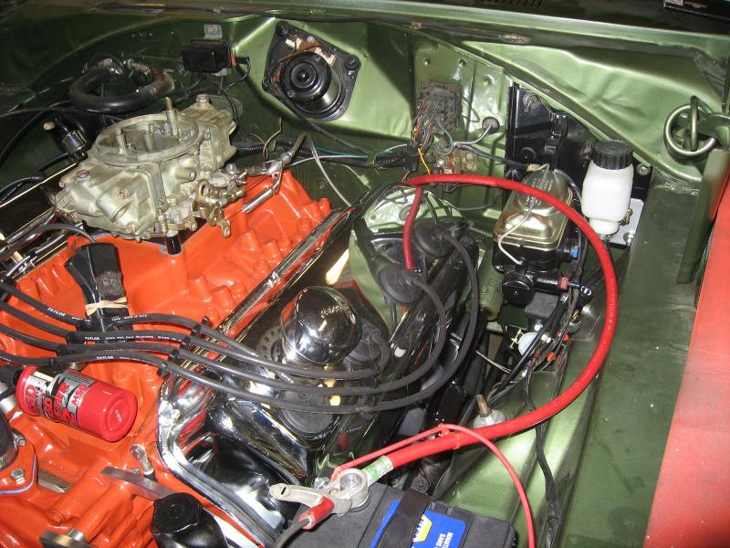

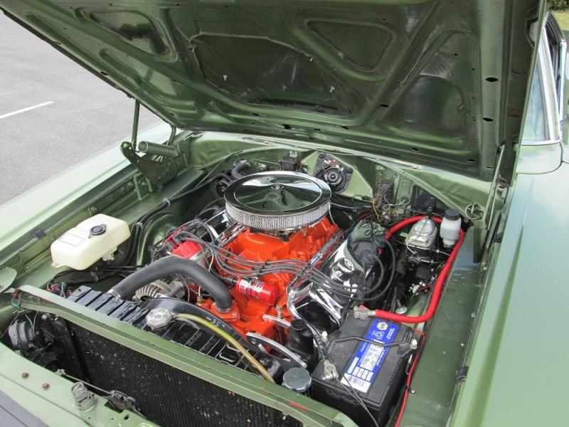

i also have one with my tko o/d 5 speed, in my hemi coronet. bought it from kiesler with the tranny. they sell it as a kit. i wanted one standard car, the rest are auto o/d's. some years ago i smashed my left hip all to hell and was liking the idea of the hydraulics
due to pressure needed for use. it worked well for that and it made the conversion from auto 318 to standard hemi a lot easier. would i do it again, probably not. my reason was for my hip, but like meep said, it's definitely not the same.

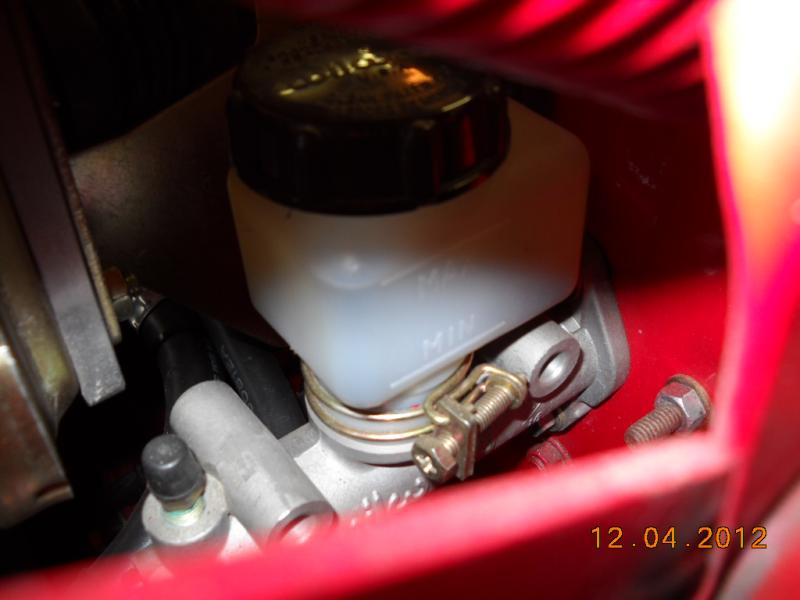

some pic's; the white bottle on fire wall is the reservoir for the clutch.
hope it helps.

does the clutch master cylinder fit can you take a pic for me

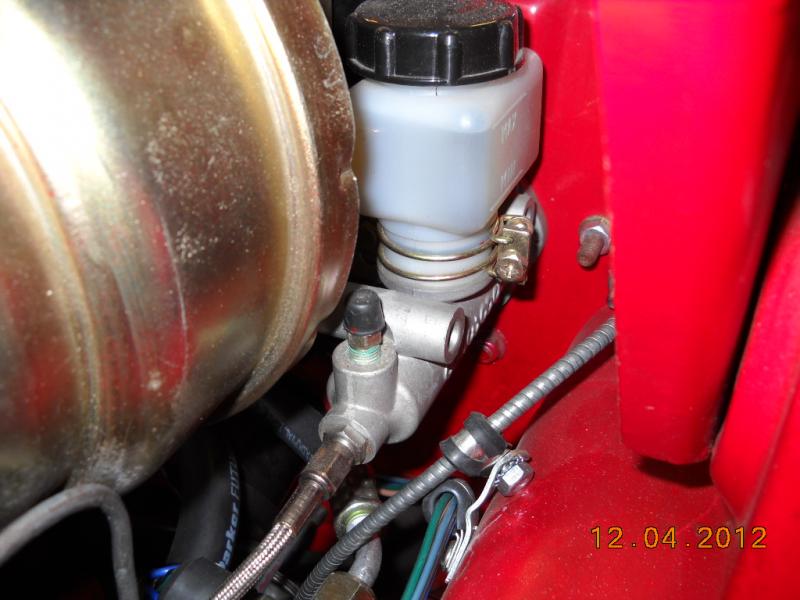

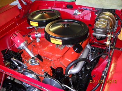

Had this picture in my file. You can just see the clutch master cylinder to the right and behind the booster. If you need more, let me know. You can download the installation manual from their site.

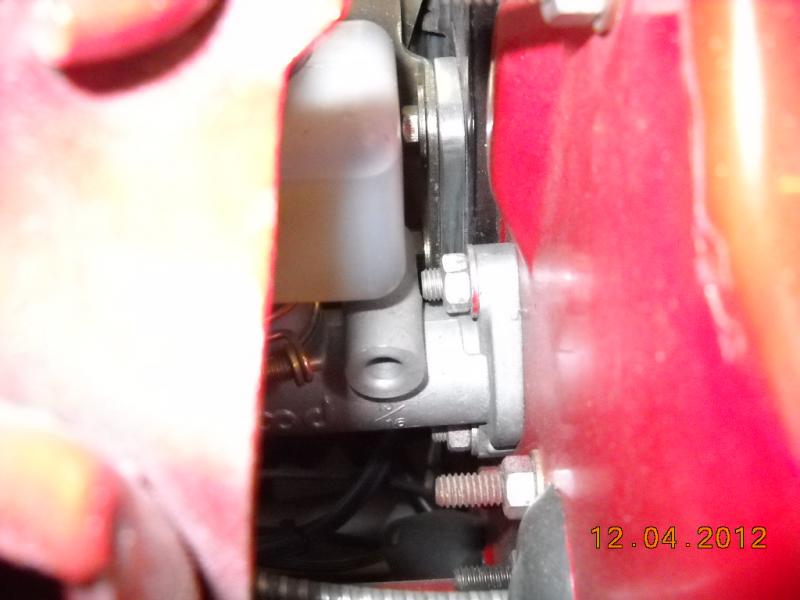

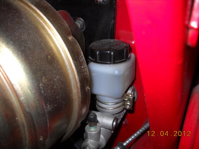

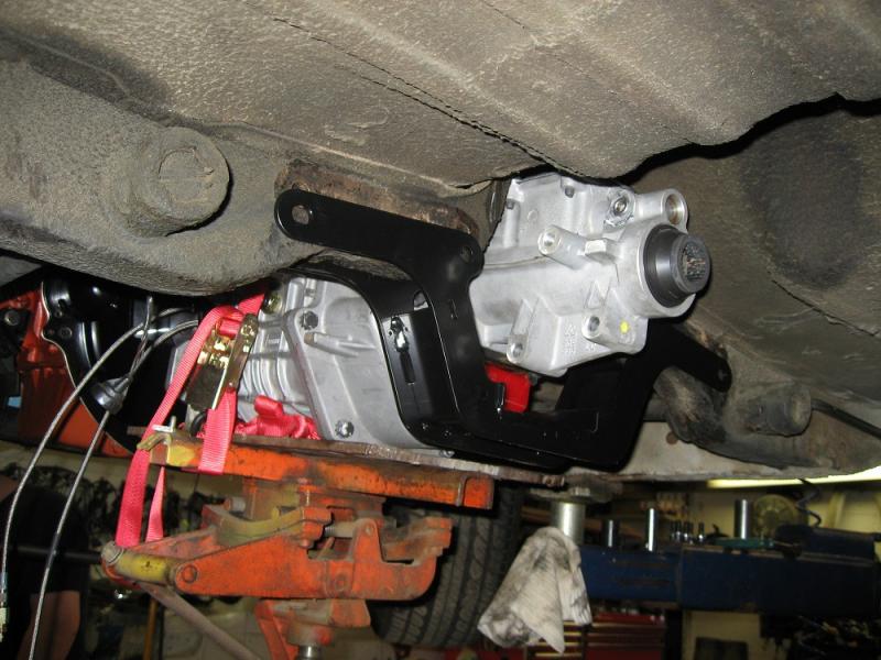

I don't remember. Car had a 727 originally. Threw some more pictures in.
Dave, that looks like a real clean install. Almost outta sight.
