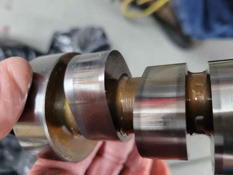

An engine builder that I know says that solid rollers start to get out of round at around 5,000 miles. I just took a solid roller out of my Hemi, it was in there when I bought it, no idea how many miles are on it. There are chatter marks on the lobes. I'm on the street so I went with a hydraulic. Will see how this works out.
