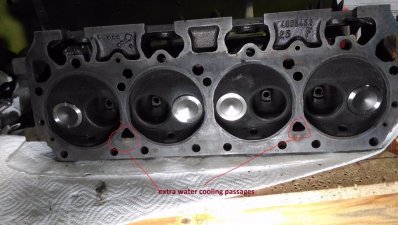

the replacements are 452's (used on the 440 tnt)
4006452 400/440 1976-78 int valve:2.08 exh valve:1.74
They have hardened valve seats and they also have two more water passageways, on the , which required that I made matching holes on the head gaskets.
Also the intake ports are cleaned up and polished by the factory.
Here's a photo...

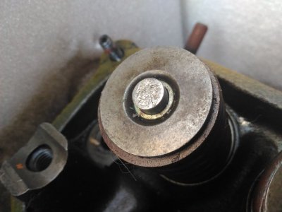

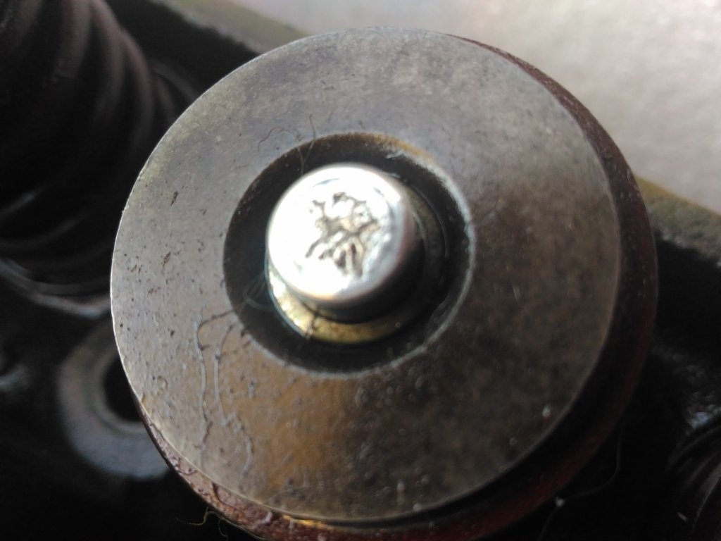

FInally - want to see what your exhaust valve tips look like? 14 of the 16 exhaust valves I had ( in the old heads and in the replacement heads were seriously damaged) The Stelite smashes away, looking like broken crystal, likely due to valve float/weak valve springs. See the attached pics.
Many thanks to those who took time to reply today.

I understand the Stellite is on the head of the valve not the tip of the stem
and when you do a valve grind they need to be cut to length
