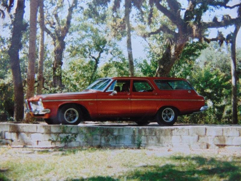

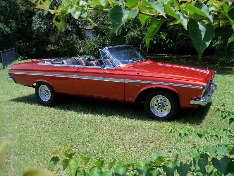

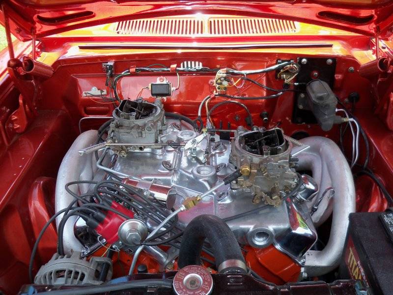

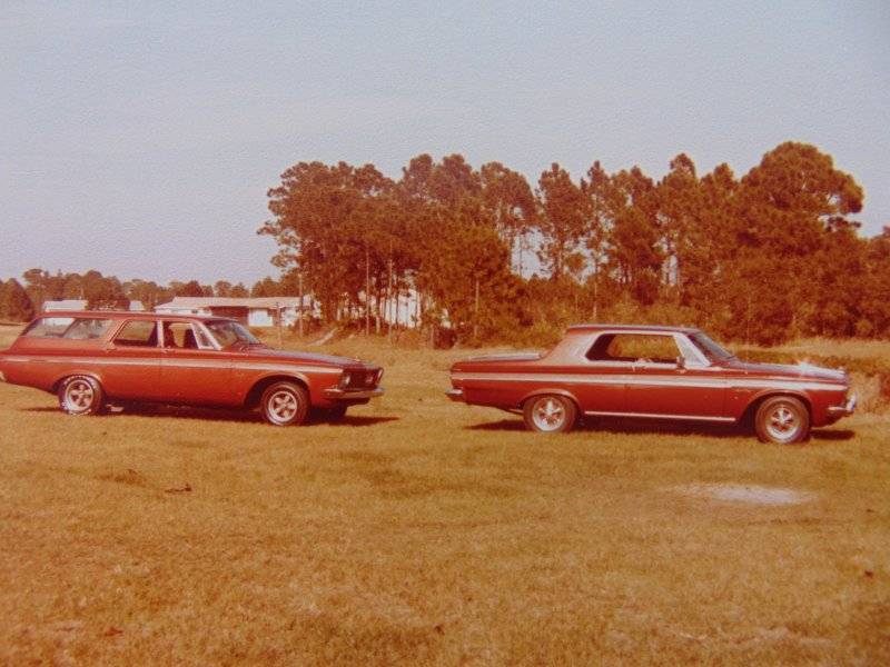

Snook--so glad to put this 65 PB tranny in your hands. I also have the drive shaft and cross member and tons of other stuff.Darrel and I have been friends for many years--if you get over to Ft Pierce you should stop by--who knows what we may solve--I look forward to meeting you--is your car streetable?? Love to see it.
I also notice in the picture above your member info a 63 Plymouth--I have 3 of them--an original factory 2drht--a wagon with a 413 and a modern 426 max wedge 5-speed OD stick convertible--They are my favorite year Plymouths
