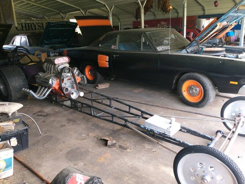

Not being a prick, just for info
you may already know too
BUT
that fuel tank ain't big enough
or what ever insuring & sanctioning body you have where you live
it will be required, no matter who it is...
*The proper cage & pipe thickness, updated & legal,
it's not 1969 anymore, that is a mandatory deal
no 'thin tube ****' like they did back in the good ol days,
(or rusted inside/degraded, from sitting for decades on end even in a garage)
chromoly hopefully, & hope it's thick enough
(should really check the tubing & cage requirements, before you even build
the car, even at a nostalgia race, it will need to pass 2022 safety tech. stds)
*driveshaft protection, you will be laying over the rear end,
straddling the driveshaft, it needs to have a "bulletproof containment"
*with hardened & a spined shaft (10 spline IIRC),
*splined/aligned hubs male & female for both the trans end & pinion
& with locking collars on the shaft, to hold them in place
*trans shield &/or probably engine & trans diaper
depending on what fuel in the tank,
but a FE & sitting behind in an open cockpit has far more requirements
*the blower needs to be contained (if you actually will run one, not just posing)
& restrained, with up to date 2022 safety stuff
not some old nostalgic 1969 stuff
that won't or shouldn't pass any good/real tech
*a full fire-Suit, probably 3-5 layers,
again type of fuel & trans will dictate some of the safety/fire requirements
*fire suppression system, usually a min. of 1 bottle halon,
for cockpit at a min., (you want it, believe me)
some will be a man. 2 bottles one for both sides of the engine
& one for in the cockpit
*it is all "usually" required
'when the transmission & bell-housing is in the cockpit' exposed
*Wear a sock or one built/sewn in the helmet,
*up to date SFI fire-resistant boots & gloves,
*SFI arm restraints,
*SFI proper dated/legal 5-6 point harness,
*SFI with a submarine belt
usually 3"
with **SFI fire-resistant shoulder straps/coverings
**a parachute if it's at all fast, 149+mph it's required/mandated
**rear brakes 'usually' on a levered hand brake
**& fuel shutoff 'usually' on the brake lever
&/or
*engine/mag./ignition kill switch, on the wheel
or within reach being strapped in
*chute lever/s easily accessible while strapped in blind, on the cage
*a SFI trans. reverse lockout/shifter, easily reached when strapped down
unless it's slow like less than 10.0 & not blown
even then
the saftey stuff is different/far more of it than a reg. door slammer,
or a street/strip deal or a 11-12 second car
even then you will be required to do the orientation drills
be able to stop 'simulation', unbuckle & get out 'blindfolded'
in less than 10 seconds
a FE & engine exposed, sitting in an open cockpit, is no joke
better know what you're doing, very quickly
you may not get a 2nd chance
1st thing is
after you check the chassis tubing & cage req.s;
*you will need to apply
& get the proper paperwork, can get off the -www- or
at the track "usually"
*You will need to do an FAA style full physical,
& be cleared & healthy 1st
& bring it/paperwork signed (by the dr.)
to the licensing rounds/track day
(best to do it on a T&T day, not a race-day)
*make sure someone with a comp license/s
*3 comp lic.'d people need to sign it & are attending
the T&T or race-day, wed. night drags whatever etc.
***some tracks only do license on certain days,
*need an ambulance & safety crew/fire crew in attendance usually too
then;
It's easy enough to get a license,
after the car goes thru a real NHRA style tech
you do your blind orientation drills, fully suited up...
Finally the actual licensing runs
get properly suited up, strapped in & dbl check everything
fire her up, put it in gear, roll thru the water-box put it in 2nd gear at a min.
just beyond the wet areas still rolling, then
*You'll do a burnout across the starting line
rolling burnouts in a light car are no joke either,
just don't let it go too far or too much RPM & blow it up in the burnout
or get too sideways
then;
back up get straight hopefully have some help, 1st few times
*1st run, stage, launch & early shutoff, are usually mandatory,
prior to 1/2 track, usually around the 330ft
*2nd run, do a burnout, a "real" hard launch like you would normally
then run it out a bit farther, than the 1st run, like 660+ to 1,000ft,
depending on what the safety crew & tech/starting line people say
click it off, where they tell you to
then;
that's if they think you're OK during the 1st & 2nd runs...
Some stuff/details all depend on how competent you were
with 1st & 2nd run
then;
hope you get that far & nothing goes wrong
*3rd run is a real-deal licensing run, full track, full pass chute/s & brake
exit to the return road, stop & roll up the chute etc.
& then tow her back & have 3 licensed 'qualified' people sign it off...
It used to be within 10% of the class you're being licensed for
if you don't know what class
*you still also can get a basic Comp License,
*you have to run better than 9.99 in an open cockpit FE car
for like SuperPro or Time Attack, brackets etc.
if (?) they think you're viable
good luck Bob
