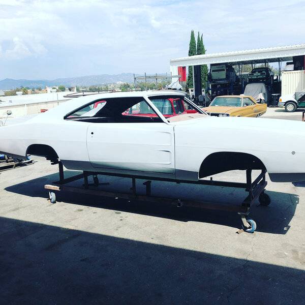

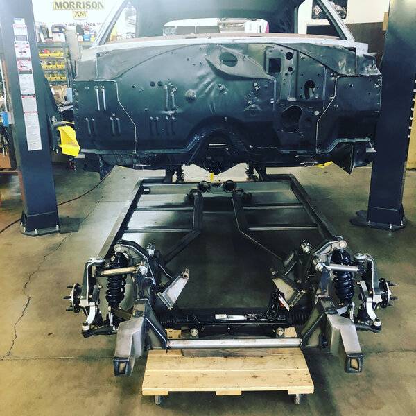

So I was minding my own business when my bodyguy said, "I found you a Charger!" Woe is me!

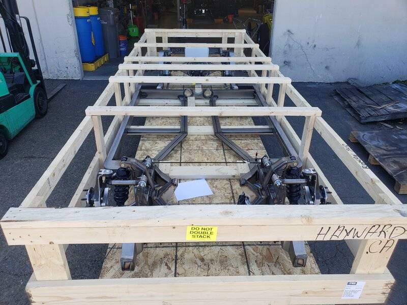

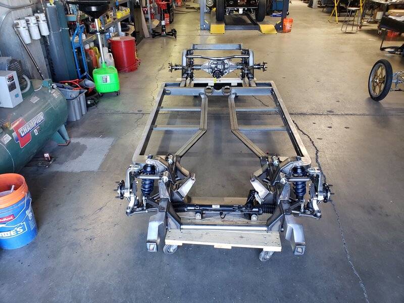

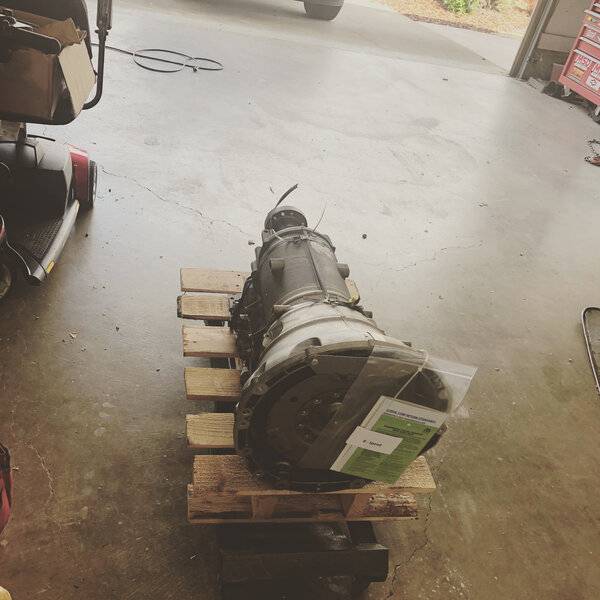

Here are some pictures to date. Brought the car home last June. The chassis arrived last week from the Roadster Shop, the Gen3 392 is on order and I picked up a 8HP80 as well.
Now the fun begins
DB037FC7-5EF7-4D60-9192-0CA79BEA4D24.jpeg BC7ECE0B-E57D-4820-A6E2-E4948383D71E.jpeg F098E434-2232-4477-8F76-46BAF5349BBA.jpeg C3517EA7-D0B8-40CB-A5A4-2432923477DC.jpeg

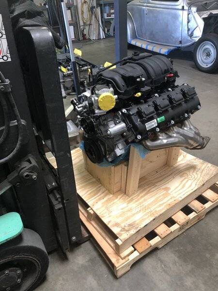

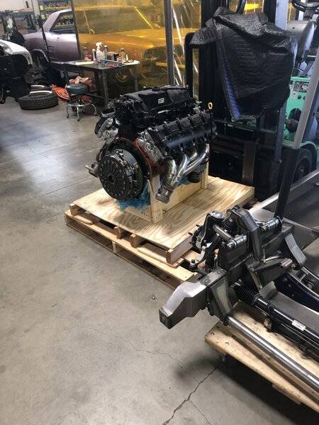

The engine arrived today, gen3 6.4L 392 SCAT pack SXT variant. Going to convert it for the 8HP70 this week, mate the engine and transmission and set it in the chassis and see what what.

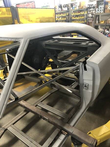

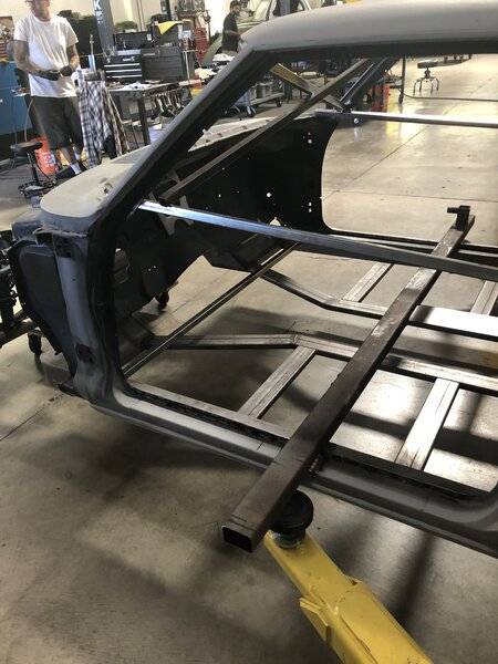

Just consider the chassis the ultimate subframe connector!

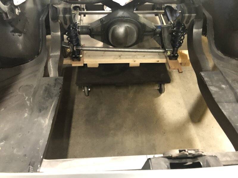

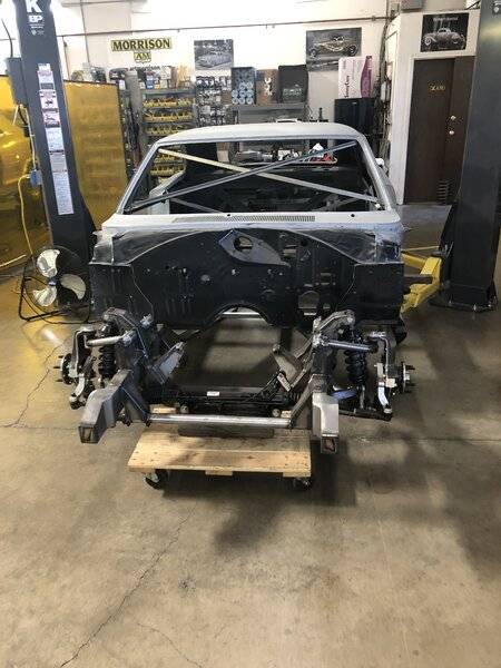

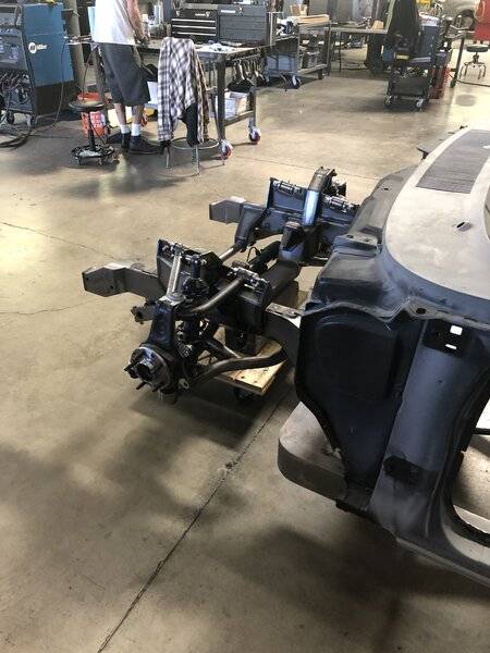

043FE494-7D37-4495-9D92-D8D57D13FFCD.jpeg 8A6166CA-6C49-490C-8AB7-DB20CA8899FA.jpeg
No turning back, the rear frame rails and the core support have been removed and the floor pan comes out this week.
That is amazing work!!! I cannot imagine the time that goes into a build such as that. I'm very jealous, going to be a sweet ride for sure!
Really nice! More info on that 8HP70 transmission please.
Is the car going to keep the drive-by-wire throttle body?
Just looked up the transmission. around 5:1 first gear ratio!
How is the transmission controlled? Factory ECU?
The 8HP70 is found in the late model chargers, challengers, BMW's,Mercedes, and others. Johnnny Mac gave me the idea and from everything I've read it's bullet proof. The engine and transmission are electronically controlled. I'm going to use a modified factory MOPAR shifter and stock ECU.
