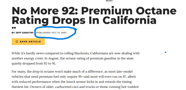

The first 440 was built and swapped in the summer of 2001. It was iron headed and around 9.2 to 1. I ran Premium 92 then...
When the octane dropped to 91, I don't know if I noticed a difference. I built another 440 in 2004, this one with 9.5 compression and aluminum heads but still ran Premium 91. That mill threw a rod at around 850 miles so I got another 440 block and got a 4.15" stroke assembly to get 493 cubes. I was now at 10.8 to 1 and still needed Premium fuel.
