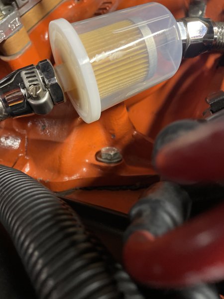

So I thought I was having a vapor lock issue. Once car would warm up it would start to buck and rough idle..eventually shutting off. Would need to let it cool down for 30-45 minutes then it would start back up but still rough. Notice at stops and going up hill while giving throttle. Installed phenolic carb spacer for heat soak. And clear fuel filter to check for boil..no boil. But low volume in fuel filter

Yes it is an aftermarket pump. Not sure how long it’s been in there.when I start it up filter is almost full the gradually decreases to almost nothing. Say 10-15 minutes

When you have the filter laying horizontally, you are going to create an air lock [ no fuel ] in the top half. And you are not using all the filter area. It will work OK, & I doubt it is causing your problem. Looks like an Edel carb, & last number of part # is a 6.

Hi. Public Service Announcement.
I had a filter like that and some of the glue that holds the filter to the top of the housing the outlet side came loose and stuck the needle open in the seat and caused petrol flooding of the engine bay.
seems over time either the heat or the fuel itself cause this to weaken. in my case went to a Edelbrock hard line banjo fitting with a serviceable filter.
