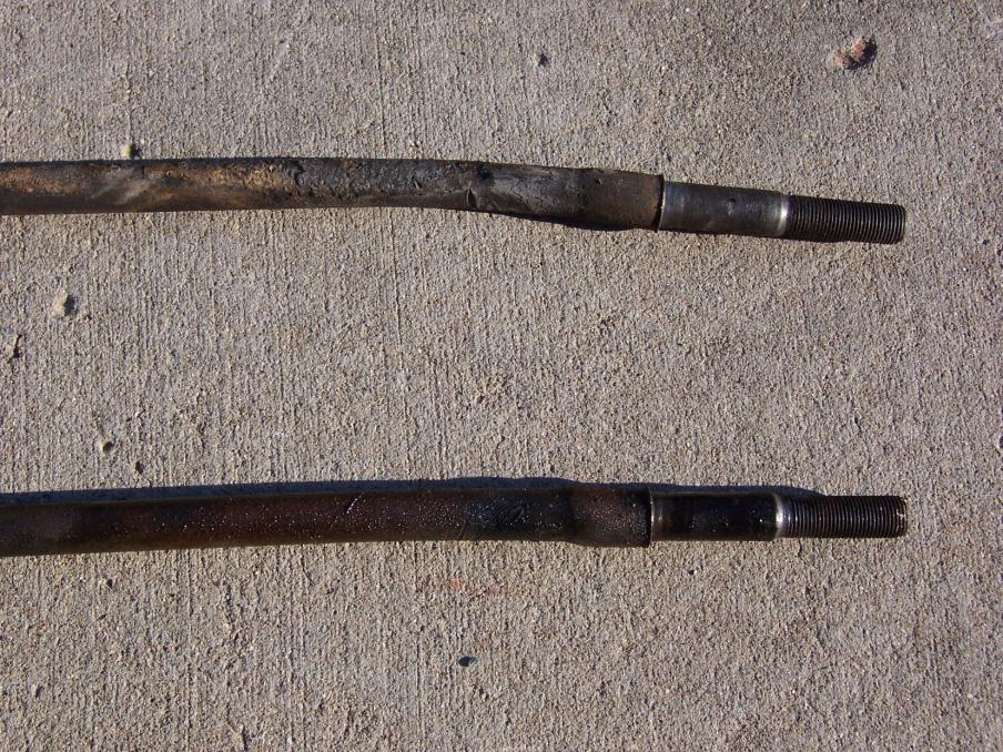

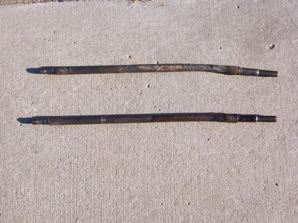

So-o-o...work progresses on the disassembling of the front end. Torsion bars came out fairly easy,and I handled them with care. Still am fighting to get the spindle/knuckle off the upper ball joint on both sides-lotsa PB Blaster there-and am keeping the removal tool on over night hoping that they'll pop off. The strut rods were not easy,but after I got them out I noticed the bends. Uh;they're supposed to be straight,aren't they? I'm screwed,aren't I? Go ahead,tell me;I can take it.

Here's the strut rods;opinions,please.
Did you take those off my car? I think they get bent when the LCA bushing wears out and we get movement. Mine seriously looked that way also.

Al, I found those bad boys, but they are bent at the lower control arm end. I wouldn't feel right giving you a pile of crap to replace a pile of crap. And I don't think they are safe as one of them looks cracked by the shoulder.
