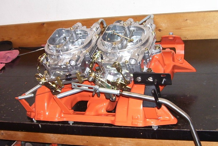

try an edelbrock ch28. dual plane high rise design. they will actually flow more air than a factory cross ram and your afb's will bolt up. should have good driveability and good low and mid-range torque.

I just talked to a mopar master who just told me the same thing. He said that edelbrock made a dual plane that just ran the 2 bbls of one carb until you wanted to go full out. The progressive linkage available from edelbrock or where would I look for what you have in the pic? Thanks for the help, sure am looking to enjoy a drive in her without sounding like I am wanting to race everyone. Im just trying to stay running. Thanks again.

the manifold, carbs, and progressive linkage connecting the carbs in the picture are edelbrock. the spring brackets, throttle cable bracket, coil mount, and kickdown rod i fabricated to use on my 65 coronet. i removed some metal from around the heat crossover.

with adjustable idle circuts it should be a plus. in fairness here i haven't run this set-up pictured on my dodge but know people who have with no complaints. i'm currently running a 6-pak and love driving on the small primaries with two bigguns sitting on the end of the dual plane. the ch28 should be very simple to tune, much easier than a 6-pak or crossram. afb carbs are very dependable.

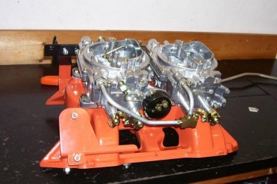

My carbs are 2 Edelbrock 600's with the same linkage as pictured above. Fuel line was also from Edelbrock as well as the air cleaner.
